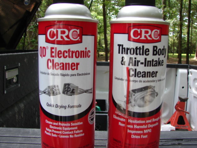

Originally Posted by MGDfan
Electronics cleaner ???? Careful - some of that stuff leaves a residue.
MAF = CRC MAF cleaner
TB = CRC TB cleaner.
Additionally, apart from unintentional damage, you may have introduced a leak upon reassembly.
That's what I was referring to here.
What did you find with the injectors? There IS a time factor here - this needs to be asddressed/fixed soonest, as every moment this persists is risking BOTH yer cats for an overrich condition.
MGD
This is what I used. My engine codes don't say anything about the MAF
The electronics cleaner says it doesn't leave residue, and my injectors all seemed fine. I turned on the key and there was no leaking from any of them
