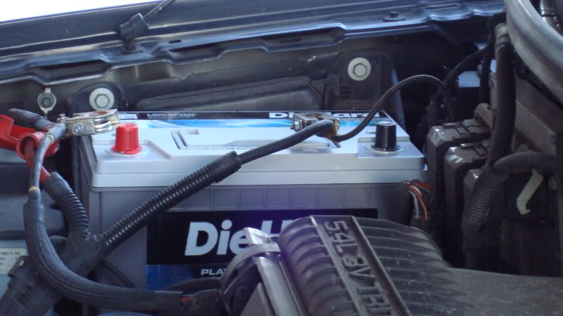

I am going to get a new battery for the 07 F150 and have decided on getting the die hard platnium. My question is the truck came with a size 59 stock, can I wedge a size 65 in there in no modification? I know the manual says 59 or 65, but some of the time the later can only be used if a certian configuration was purchased. I don't have the truck int he driveway right now so I can't measure the battery tray. I was just asking cause I know someone has attempted it.

Hey guys thanks for the answers, ya I got the sears platnium 65. As 26point2 said I also had a few is thing going to start moments on low teens mornings. So far the truck has been starting good, don't know if it is really any faster than the old motocraft. I also think it should have handleded the cold mornings better then it did with the truck not really sure if it was going to turn over. Then again maby I am expecting too much out of a 200$ battery? But it does fit nice and snug in the battery tray

Sears Plat

[QUOTE=HypnoticPigeon;4772568]Hey guys thanks for the answers, ya I got the sears platnium 65. As 26point2 said I also had a few is thing going to start moments on low teens mornings. So far the truck has been starting good, don't know if it is really any faster than the old motocraft. I also think it should have handleded the cold mornings better then it did with the truck not really sure if it was going to turn over. Then again maby I am expecting too much out of a 200$ battery? But it does fit nice and snug in the battery tray [QUOTE]
HP, do you realize the battery you had in there was a 540 CCA battery? It looks like the Sears Platinum (Odysey) that you rteplaced with is 930 CCA's. (kinda hard to tell with it upside down but with a magnifier that's what it looks like). Ford ought to be horse whipped for putting that small a battery in that truck. My wife had a '88 Mercury Topaz w/ 2.3 4 cyl. that used the same exact battery (factory installed). She later had a '95 Taurus 3.0 V-6 with the exact same battery (factory installed). I know, my SIL has an '07 F-150 XLT Super Crew 5.4L with the same 540 CCA battery, but to me that is unconscionable. How can a 540 CCA battery start a truck with a 5.4L in -20 degree weather? Or does no one drive Fords in -20 degree weather? Maybe there's something wrong with your starter because that SP should absolutely put a NEW 540 CCA to shame. Amps are what gets the voltage to where it needs to go and there had to be a huge difference between what your old 540 tested in amps and what the new battery tests.
