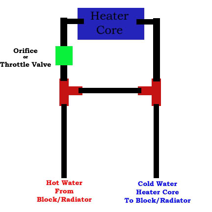

It finally got hot enough today for me to really test the A/C in my truck.
Had the Panel on 60F and it just wasn't cold enough. Hate to bandwagon, but this mod is just screaming at me. I'm worried about corrosion in my Heater Core though. Since I live in Hawaii, the Heater won't be used until Jan 2011 at the earliest. Lowest temp I've seen in 8 months has been 65F so far
So, I'm going to get a 3-way tee (x2) and a orifice/throttle vlv + some heater hose. The pic below demonstrates what I'm going to build. This way I can keep some flow through the heater core, but still minimize it's effect on A/C performance.
I'll probably end up using a throttle valve vs. orifice and just crack it open slightly until I feel a slight change in temp on the outlet of the heater core. That should provide enough flow??? while effectively bypassing the Heater Core

the heater core itself won't necessarily corrode away. but the chemicals in the coolant and any little impurites from the engine and radiator can/will collect in low flow spots (aka core with flow cutoff).
these impurities then "breed" (for lack of better term). also, over enough time, enough will deposit to clog passages.
we're not talking about immediate failure...but over the course of 4, 5 years I can see this causing premature failure

All you have to do is open the valve once every 1-2 weeks and let the coolant flow thru for a few minutes! Come on guys,this is not rocket science!
