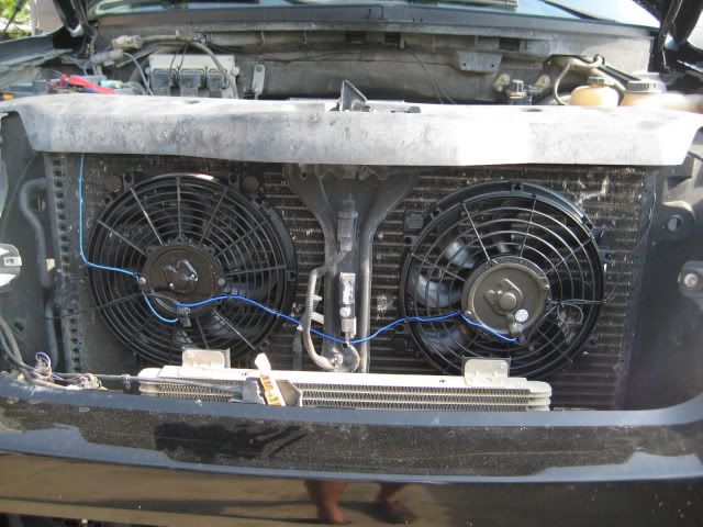

a/c issues w. my 2004 F 150 resolved
I finally successfully calibrated my A/C on my 2004 F150 FX4, I had been having trouble for the past 2-3 years. Every where I went to they wanted to change the whole system since my truck has a body lift they also told me that I have to put two electrical fans in front of the condenser. What we figured out was that we had to force air into the condenser in order to calibrate the a/c so, anyone out there having problems with their a/c calibration force air into the condenser in order to properly calibrate.
Now my A/C works better than ever plus my condenser and motor run cooler with those 2 fans. FYI:you can get these at any O'Reily's or auto parts store but, preferably racing performance. Thanks.

Do you have more info on this? I am needing to do the same thing with mine. How do I go about recalibrating the ac? Am I just supposed to install the fans so it blows constantly over the condenser? Do you have any pics of the fan? Thank you
or
even better a link to something I can read and have all the questions answered?

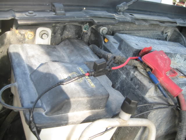

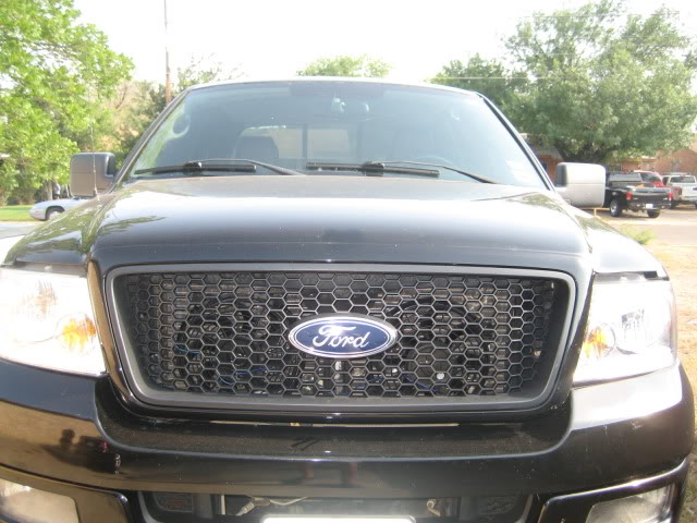

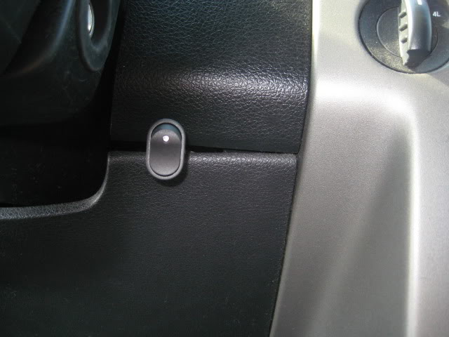

once you install the fans take it or if you know how to charge your ac with the required amount of freon using gauges.In my case the specialist just calibrated to the manufacturers specification.Here are some pics .
