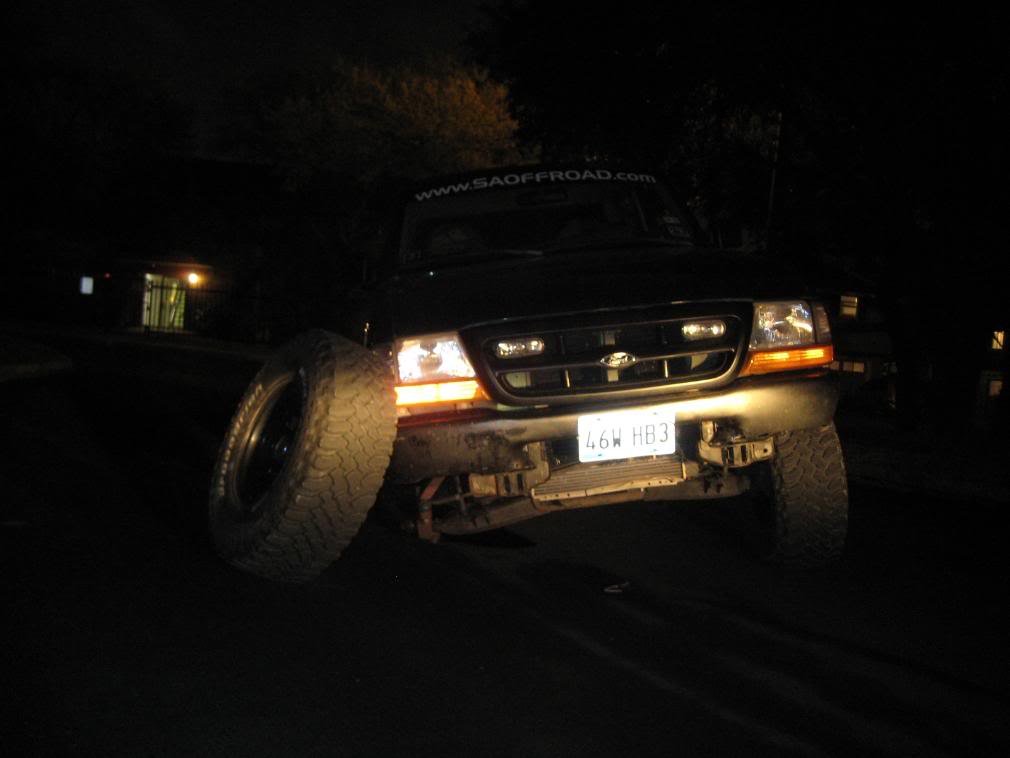

FYI word for the wise i bought this lift for my ranger i had
http://cgi.ebay.com/ebaymotors/98-99...item5ad79ab66e
and this happen the spindle broke at the shaft it broke right in half and i was only running 32's on my ranger ... this was a known problem for that brand of lift as well as others fab tech ...
