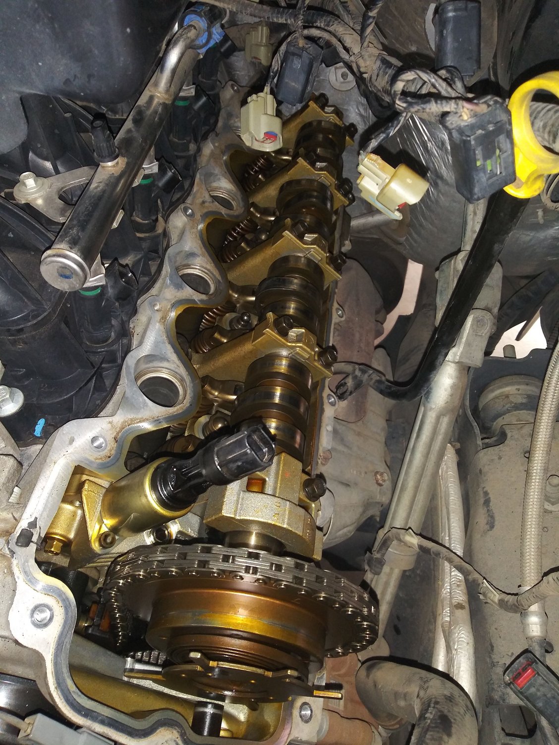

Well, I pulled the valve covers off. I found the exhaust roller follower had been spit out on #6 cylinder. Cam lob is scratched up and lifter has some knicks on it.
I ordered new lifters and rollers. Was thinking about reusing the camshaft. It's marred up, but no deep scratches or chunks missing. Anybody have any thoughts? To reuse or replace cam?
Old Jun 12, 2019 | 01:42 PM
Posts: 43,528
Keep in mind that there are no removable/replaceable cam bearings.
