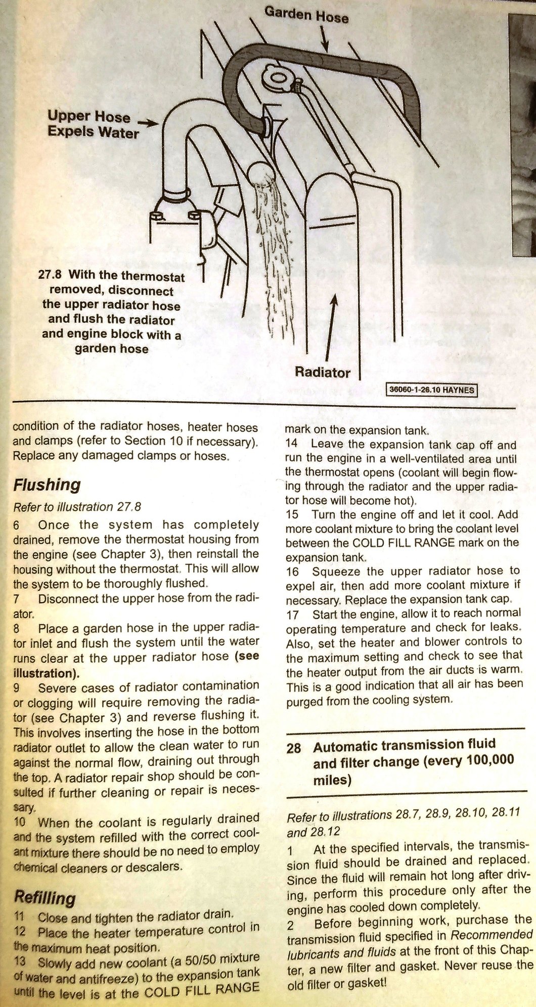

Your options are to follow GLC's instructions and buy one of those kits, do whatever you have always been doing, or try something different. Here's a pic from the page in the Haynes Manual of coolant flush. There si a good video online. You could simply drain the radiator and overflow tank, refill, and and maybe repeat that annually. Or drain the radiator, remove the thermostat, add distilled water, run engine, drain, and repeat until it's clean. Then drain again, install new thermostat, install new hoses, and add coolant to proper mixture.

In the above image, the upper radiator hose is removed, and coolant is allowed to flow out, spray everywhere, and leave a big mess.
Try using a length of tubing. Attach tubing to engine in place of upper radiator hose, and run the other end into a 5 gallon bucket or water bottle. Now you won't have poisonous coolant all over your garage floor, in your driveway, and running into your storm drain.
