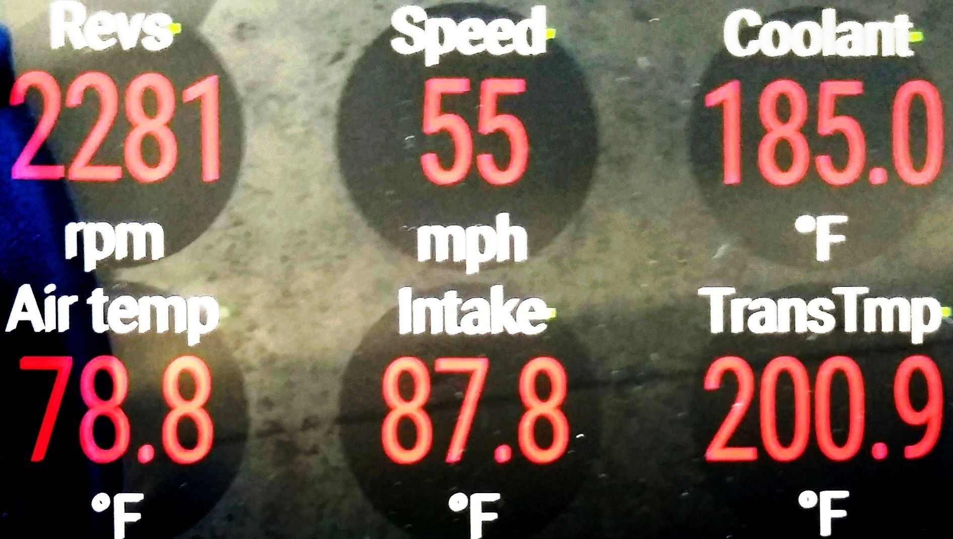

It looks like cars today operate at higher transmission fluid temperatures. Has anyone else noticed this? I am using Torque Pro app. I suppose this must have something to do with the cooler bypass valve.

It's not that they necessarily operating at higher temperatures, but it's the fact that most modern engines put out 2x to 3x the HP and torque compared to older cars. So of course they are going to run a bit hotter.
Also the manufacturing tolerances allow for this.

Today's transmissions are designed to operate at those temperatures.

Thanks guys. Good insight. I have to step out of the dinosaur era. I'm still looking at all of those old charts showing 175 F as an ideal operating temperature. OEM thermostats open at 190 F. Is it safe to assume that the OEM cooler bypass valve closes at 190 F?

185 to 200 is normal, it's safe to 230. Make sure you use Mercon LV.
