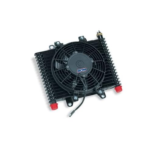

I like the Troyer Performance Active Automatic Transmission Cooler Kit
PPI-ATCKIT
also.
But while searching online, I've also seen the B&M Racing Hi-Tek Automatic Transmission Cooling System.
The difference in cost is trivial at this point. Saving $10 or $20 will not help me if I get a cooler that does not work as well. After all, what will a new transmission cost?
Which one do you like better? Are there others that I have not seen yet?

To me it looks like 6 or half a dozen. I would proably go ahead and go with the cheaper one (how much is the B&m ?) Also, the bigger cooler B&M offers looks a little bit bigger then the Troyer cooler, and flows about 100 cfm more, but I wonder if it too big so it would cause a drop in fluid pressure ( i wouldn't think so, but not 100% on that)
The Troyer also comes with plenty of hose, so you can cut to length and mount where you want, kinda nice. And its more then enough "cooling" power for any of our applications. Also look into an aftermarket tranny pan. They can add quite a bit of fluid, which in turn allows for lower operating temps. They are also generally aluminum finned, allowing for quicker heat transfer. They also usually come with nice drain plugs and other neat "extras". I personally am running the Mag Hytech tranny pan, love it.
