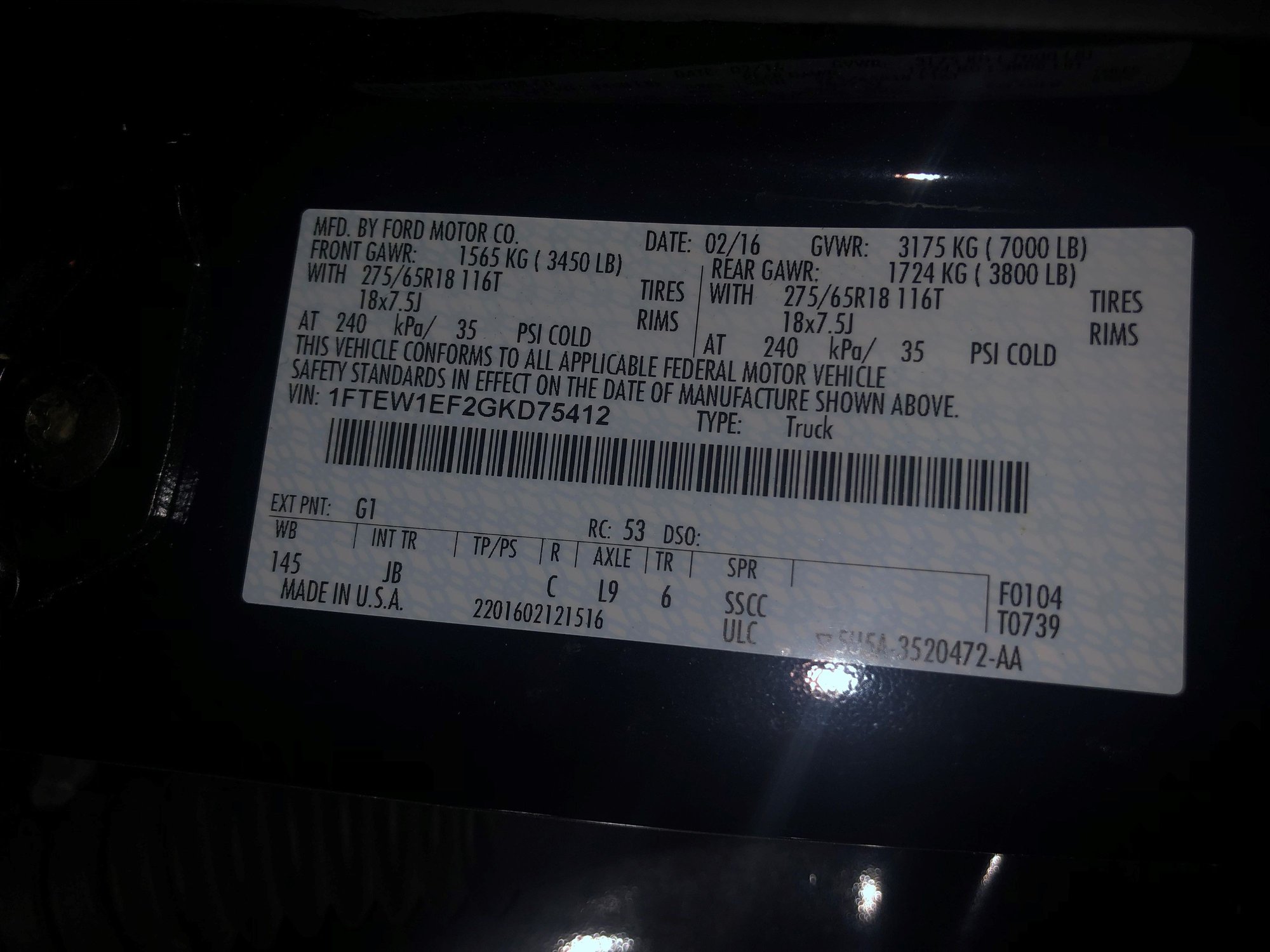

OK, the major limitation you will have is the tongue weight of the trailer you choose. It puts its weight on your truck's axles. A 4,000# trailer will have around 600# of tongue weight and you need this value to keep the trailer from fishtailing, which can cause you to lose control, wreak your trailer and truck, and possibly damage or kill yourself, your family and other motorists around you. A 5000# trailer will have a "dry" tongue weight of around 750#. Notice I'm giving you a 15% figure in both cases - you should plan on that because in my experience all trailers weigh MORE than their "dry" weight, and if you add anything, like full water in the fresh water tanks or, any cargo, the weight increases even more.
Without a weight distributing hitch, ALL the tongue weight is placed on your truck's rear axle, which has a weight limit of 3800#. The front can only hold 3450#. Again, in my experience, and certainly in my truck, the "dry" weight is much lower than its actual weight and you really need to find out what load is already on your truck's axles by taking your truck to a CAT scale and weighing the load on each axle with you, your wife and child, dogs, and all the camping equipment you would be taking on board. That will tell you how much additional weight you can place on each axle. It will be smaller than you think. You may find the front axle is your limiting one.
DO NOT even think of using airbags! They are only good for leveling the truck if you put a heavy load in the bed, such as 1000# of concrete in bags. To tow a trailer of the size you are considering, you absolutely need a Weight Distributing Hitch (WDH)! This will not only level the truck (and trailer) when towing, but it will also move about half the tongue weight off the rear axle and put it onto the truck's front axle. Without a WDH, your rear axle will probably be overloaded, your front wheels will be lifted some off the road (which hurts steering), and limits the braking effectiveness of the front wheels, where most braking occurs. This is further aggravated by the fact that if you brake without a WDH, the trailer nose-dives, pushing your truck's rear down more, and lifting your front end more! All told, it's an accident waiting to happen.
An Ideal WDH should be rated to carry the tongue weight, so for the two loads I gave you at the beginning, you would want one rated at 800-1000#. You'll probably need a drop shank on the towbar since your truck is lifted. The WDH should include sway control too, even though your truck MAY be equipped with builtin sway control if you have the tow package.
Your truck will easily pull a 6000# trailer, but the tongue weight would be 900# or more. I think that would overload your axles, even with a WDH. Again, DO NOT use airbags when towing, They don't let you set up the WDH properly and you probably would eliminate all the benefits of the WDH if you used them.
