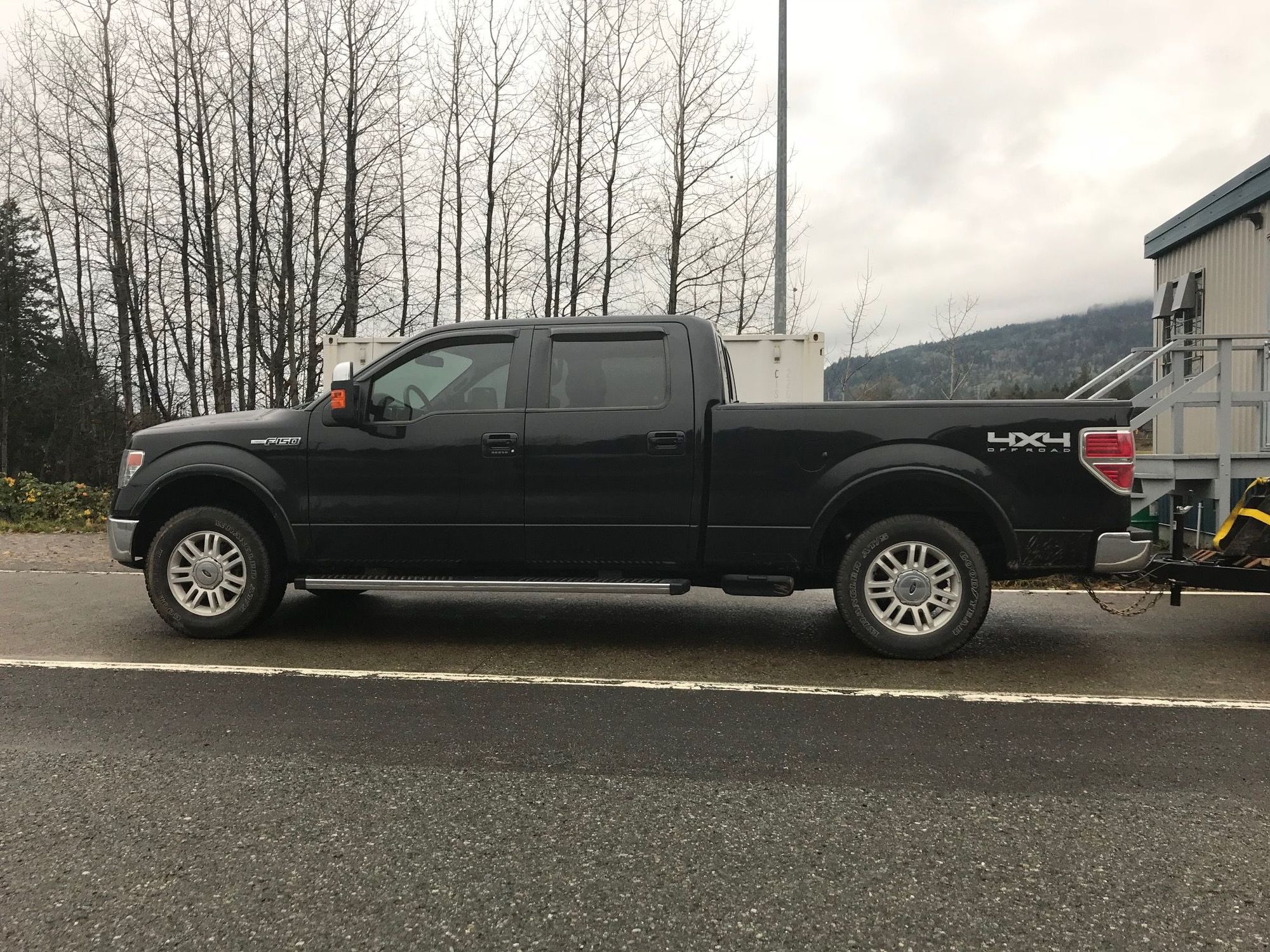

Here is my truck and trailer.....yea...hitched. I spent all morning at the truck scale checking every different weight I could. I move the tractor.....get off....for tongue weight. Vehicle only, hitch only....trailer entirely....and no matter how I figure, I am as safe and under max weights on all aspects. Except for ONE. The carry weight of the receiver. Yup, I can get a WDH, but it would be just window dressing. I have everything nice and level also.
I have researched like a fiend this week on this as I DO want to drive safe. The CVSE, RCMP and the Ford Dealer have all physically viewed my setup and stated I'm towing legally and safe without a WDH . It's not a requirement for the CVSE and the RCMP. I then went to the Ford Dealer and had them bring up my build sheet. This truck was ordered with a Max Tow Package.....I saw it right there...in black and white...errr..pixels. Parts manager said your good to go. Class IV hitch. All three of them actually pointed the one line that is on my sticker:
"Ratings may vary with vehicle equipment"
I just want to know if my receiver will break off with a 750/5200 lb tow.

No, the receiver is a class 4 - good for at least 1000/10000. The WDH spec is for the truck - to avoid overloading the rear axle. If you aren't over rear GAWR you are fine.
