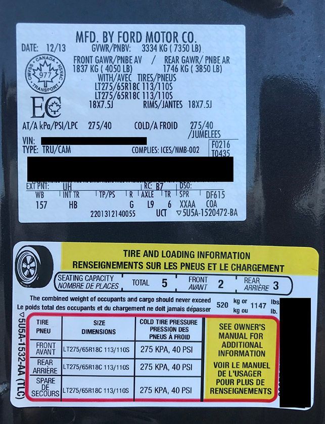

What gears do you have? Post the AXLE code from your door jamb sticker. Also, please post the GVWR and payload rating, that will help sort this out better.

Here is the label.
You have the regular (not Max) tow package with standard payload. Depending on bed length, your rating is 7700 or 7500. You also have a class 3 hitch, not a class 4.
