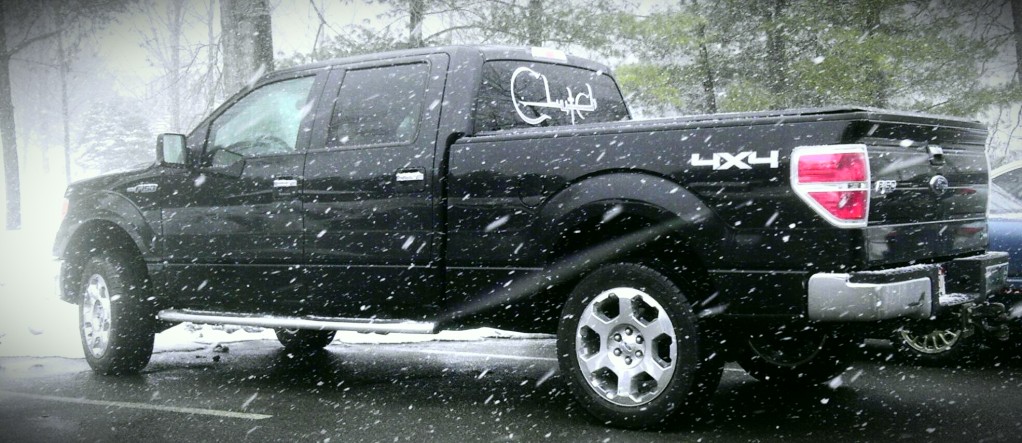

2 1/2" front 1/4" bigger block in rear. 275/55 R20 tires

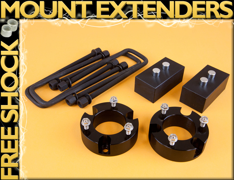

The kit I got is an eBay off brand. It actually raised it 2 3/4" in the front. Which made it a pain to get the lower strut bolt in at full extension. Because the coil was hitting on the upper a-arm. but Sitting back on the ground you get your fingers inbetween them.

O yeah, the shock mount extenders are useless. Lol!

Imo search for one that offsets the strut inward. It will make installation easier.

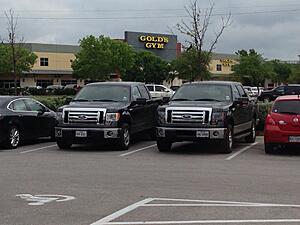

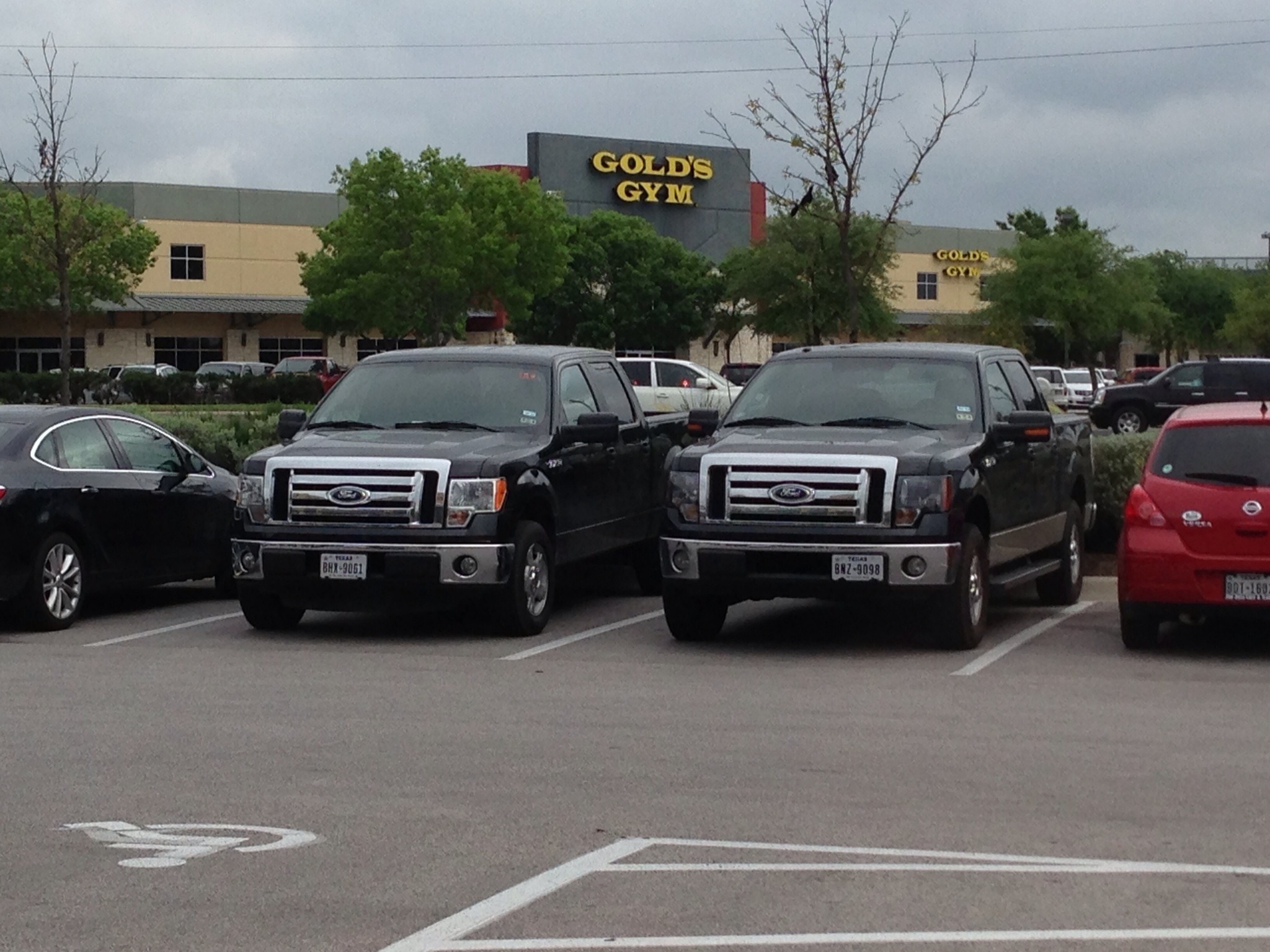

I've got the 2.5" rough country in the front - nothing in the back. No issues.
Here's a pic side by side in case you're wondering what it looks like. Both 2WD's - Mine is leveled on the right.

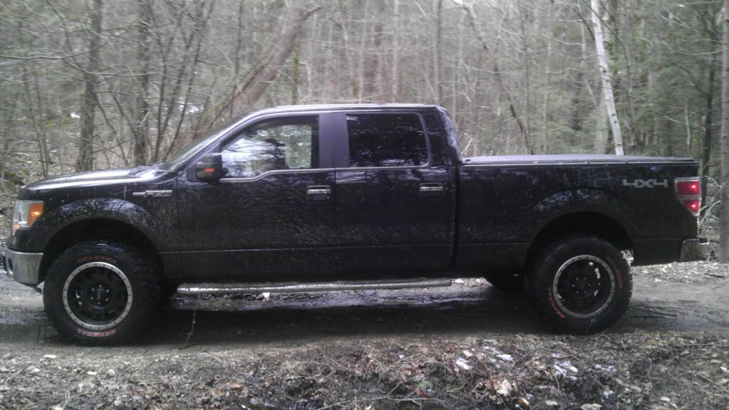

Here's a pic of mine with the 35's. Very minor trimming and rubbing.

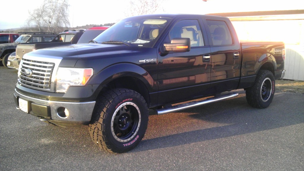

This is a better pic

Your truck looks great. What leveling kit go you have? You have the same wheel and tire setup that I'm getting except I'm going down to 18's.
