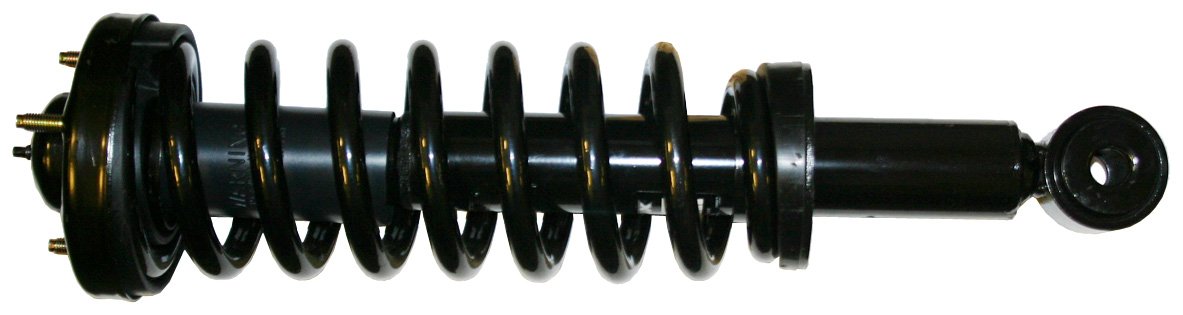

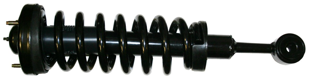

I have been on the ground looking really close at both 2WD and 4WD trucks of mine and your vintage and I have yet to find a difference in lower control arms. Even the steering knuckle starts out the same. I have not looked at a 4.2 equipped truck though but I can't imagine Ford using special LCAs on it?
What is different is entirely in the shock and the spring perches which in the case of 4WD put more shock below the spring. The shock that is there is shorter in body as well and the 4WD uses a "stalk" below the shock to pass the axle half shaft that a 2WD doesn't have. The lower shock mounts to the LCA about 2/3 the way out between the inner control arm bushings at frame and the lower ball joint so 1" at the shock mount is about 1-1/2" at the ball joint movement.
Look again at a Monroe replacement front coil over shock for a 2WD vs a 4WD truck like ours (mid Y2Ks F-150s).
2WD is #171362

4WD is #171361
http://ecx.images-amazon.com/images/...L._SL1187_.jpg
In my case I lowered my FX4 front by shortening that stalk 1-5/16" which dropped my front right at 2". I removed the rear 2" blocks and used new shorter U-bolts. I have measured close and rear shocks will bottom only if I totally bottom the axle on the frame bump stops ..... and not likely in my use.
