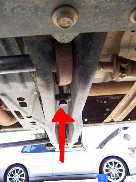

Looking to adjust my torsion bars tonight and want to make sure im turing the right bolt. Is this the bolt I want to turn?
  #40
Old 05-18-2010, 12:24 PM
wandell's Avatar
Join Date: Sep 2001
Location: cairo,ga
Posts: 28,203
Received 2 Likes on 2 Posts
Yes.

No need to remove the wheels. All you need is a socket or wrench. It is easier if you jack the front of the truck up to where the wheels clear the ground. Turn each adjustment bolt an equal number of turns until you get the height you want. Make sure that your CV and ball joint angles don't look insane (like when the front tires are off the ground). Then get the front end aligned.
