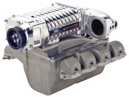

heres the 3 valve i found cant find just the plate, but

Old Oct 20, 2013 | 02:07 PM
  #43
flux's Avatar
Joined: Jun 2013
Posts: 28
Originally Posted by Crash!
That is the piece included in the upgrade kit. Tuner kit only, once again. But JDM has the tune and a list of fuel and air system mods.
The finished product. Midplate included in the kit. The base SHOULD be the same, as it bolts to the Lightning intake. The rise and bolt pattern on the adapter is what will be different. It looks like it increases plenum volume, which is a good thing.
The same link I posted above, although I had that image in my hand two days ago, and believe it or not, have been searching for it since. I am all over this, even when you think I am sleeping... LOL!
http://www.whipplesuperchargers.com/...sp?ProdID=1170
You are going 2 valve aren't you? Now let's move forward. Call me so we can nail down the details and decide who is going to build your engine to start with. We have the blower and fuel/air system nailed down for sure.
no, prob. 3 valve.. thats why im comparing plates
the top is the kit that fits 04 to 08 f150, the bottom is the
plate for the whipple lighting kit with the 2.3....
thay look to be very close..

I know the 3.4 uses the 2.3 Lightning inlet elbow with a reducer. This elbow will not fit onto a 3v mid plate.
If you fitted a 3.4 then you need to move the bridge and drive pulley forward 22mm (7/8)
Old Oct 20, 2013 | 06:21 PM
  #45
flux's Avatar
Joined: Jun 2013
Posts: 28
so the 2.3 and 3.4 are the same length?
