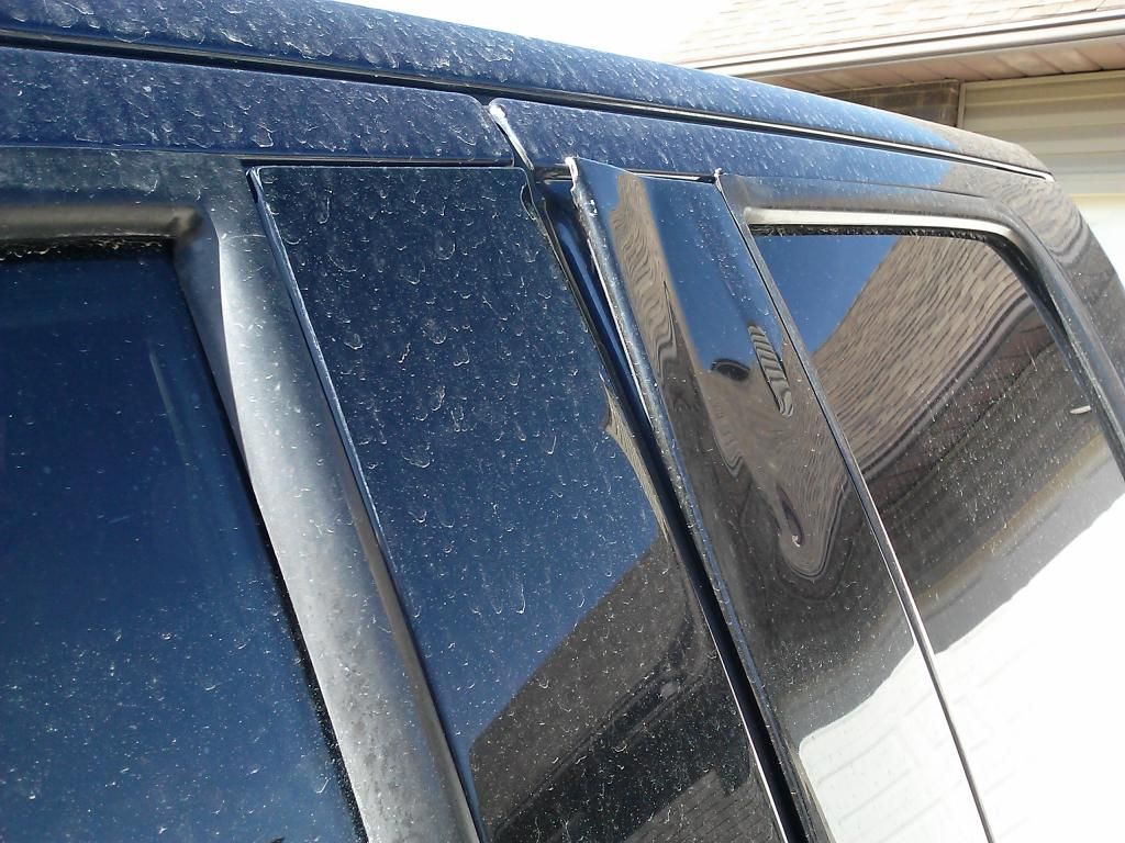

Here is the "pillar" in question. Dunno, is it called a pillar? At any rate, it be terribly bent.

This thread in Articles and How To might help.
https://www.f150online.com/forums/ar...-how-pics.html

PERFECT. Thank you so much!
There ya go! That's what I was talking about, but didn't know that that would work perfectly. I thought your metal pillar was bent and that these would just cover that up.
