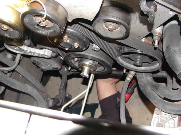

The 2002's dont have the ring bolted to the crank... Inthe 99-2000s there were 3 bolts behind the cage and pulley that held the ring that the pulley spun into on the crank... Not sure what your choices are now... I would call JDM
Here is a picture of one I worked on.
You can see the 3 bolts in that picture...

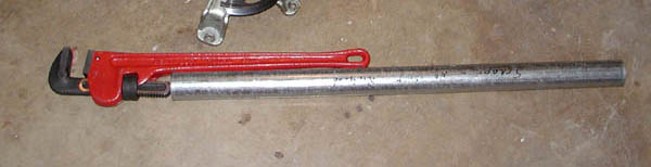

I used 24" pipe wrench and 3 foot cheater and all it did was grind metal off the shaft stub.
Doug

this was the sob, that wouldn't budge. i was going to cut it in half with a sawzall, so that i could get to the 3 bolts. JDM said to try the pipe wrench on the hub of the pulley. it worked, and i was able to unbolt the spindle.
Doug
So doug that is a 01/02 style?? Looks like my 00.

The above picture is a 99/00 style.
This is my 2001
Still can't get this off. Any suggestions? I'm guessing a cutting torch may damage the oil pump, oils seal, crank???
