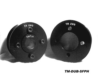

Here, I found what I remember. I am not sure this will help you, though.
https://www.f150online.com/forums/sh...threadid=54424
You need to call South Florida Pulley Headquarters, but I can't find their damn #. Here is their email, though:
sfph@southfloridapulleyhq.com
I found this picture:
Do you have yours installed like this?

I talked to Terry, the owner of South Florida Pulley, He hooked me up with the Company that made the Tool. They're sending me a new 8mm Screw for the Puller Tool. SVT MoonShine has the right method, Unfortunatly There aint no way in hell I'm taking that sucker off to try it. The writting does face outwards and mine is correct. Within the next 6 hours when the light comes up, that suckers going on ALL THE WAY, one way or another. I still have 9 threads left sticking out the end of the puller tool shaft, that'll be enough.
