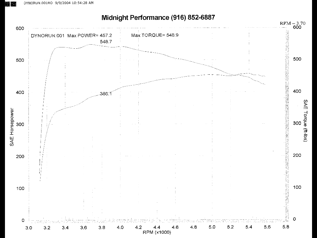

Old Sep 9, 2004 | 09:47 PM
camcojb's Avatar
Joined: Feb 2003
Posts: 1,051
From: Wilton, Ca.
Here's todays dyno results. And no, no rods hanging out of the block!
dyno results
Here's a (poor) copy of my scanned dyno sheet:
dyno sheet
Jody
