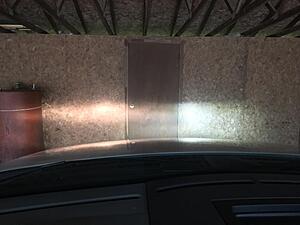

I do have a full review coming of 4x4TruckLED's lights that he sells. I actually just got all the pics last night and will get the review up tonight or tomorrow after work.
Below, I have a couple comparison pics. The LEDs vs sylvania zxe halogen. The led photos are not the ones from last night. They are from the night before and there was still a little light in the sky. However, that light was not on the ground, the sun had set and it was just a tiny bit in the sky. I retook them to be 100% fair.
Halogen:
LED:
Halogen:
LED:
Halogen on left, LED on right:

Good pictures! Looks to me like the LEDs still have a good cutoff to avoid blinding other drivers, but that they fill in the area below the cutoff better. And, they are WHITE, not yellow like the halogens.
- Jack

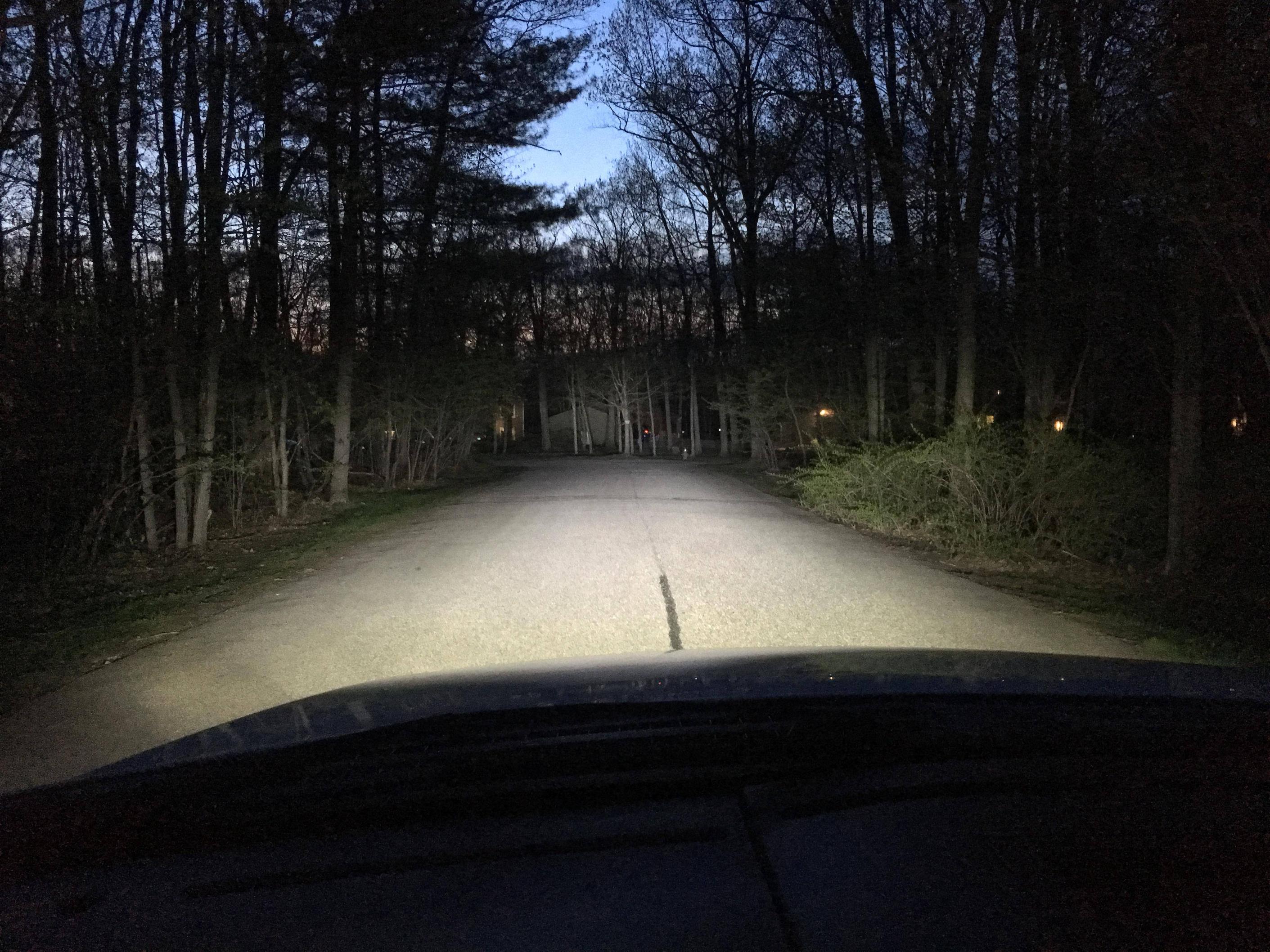

Thanks. I do like the look of not having yellow headlights. I think it compliments the trucks appearance.
