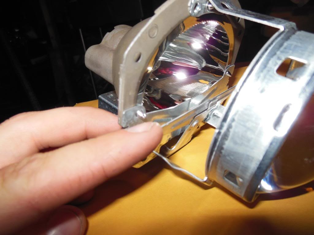

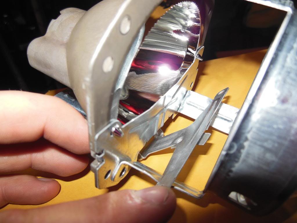

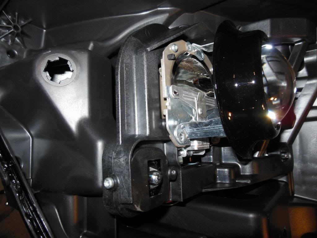

The HID bulb is 100% fixed in place. The bulb is at full output all the time and when the highbeams are selected a small shield drops out of the way and allows the full beam to be projected.
Here's some pictures of it:
