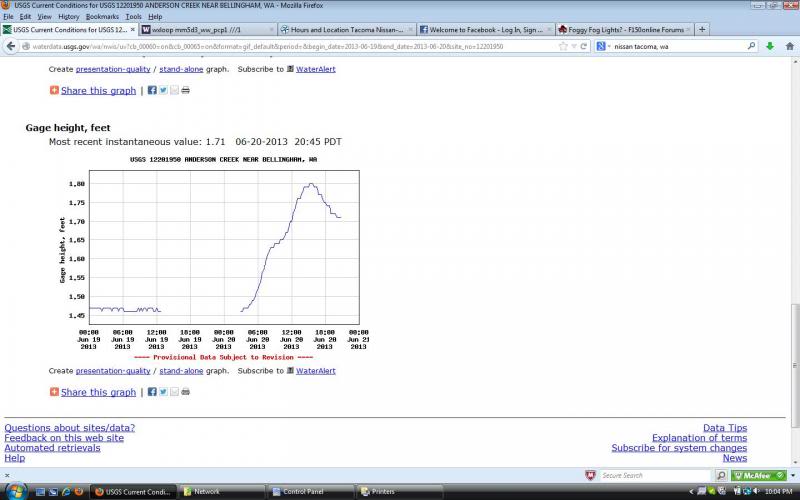

this may be a dumb question, but are they like headlights that have a "breather tube" to allow movement of moisture and air? could be clogged/pinched? id go out and look at my truck but it is pouring here for some reason
