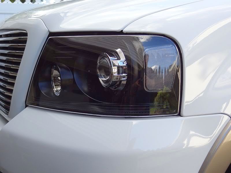

Very cool.. I did just about the same setup a couple months ago.. Only I painted a set of chrome heads with clear corners satin black and went with the 3Five with 5k bulbs. Great people over at TRS. Definatley a nice mod. Take pics along the way, I took photos of Everything.. Have fun..
Quick pic of how mine came out.. I love em!

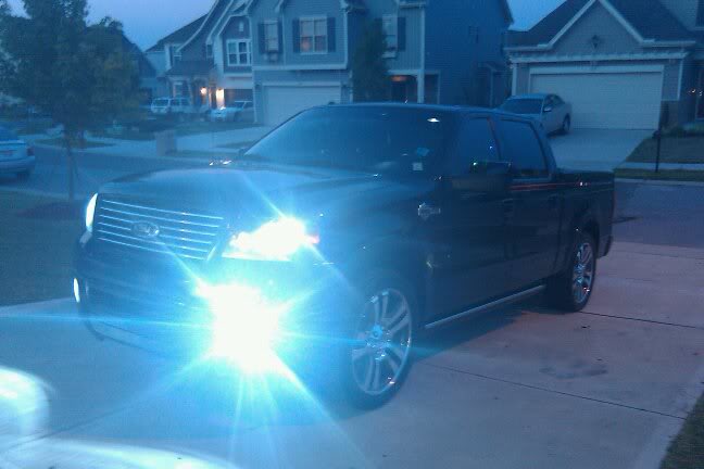

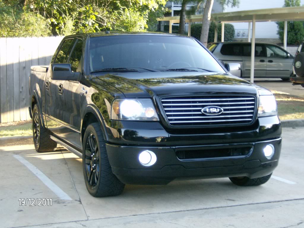

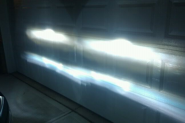

While I can't compare to the 5k I had 6k heads and 8k fogs in my Harley.. Maybe this will help give you an idea
I did not retrofit them obviously but they were awesome and I never got flashed after reaiming.

After about a year the fogs looked to have dimmed to more of a 6k to the point you couldn't tell a difference between them and the heads. They were just a cheap $50 set compared to the $250 set I had in the heads.
