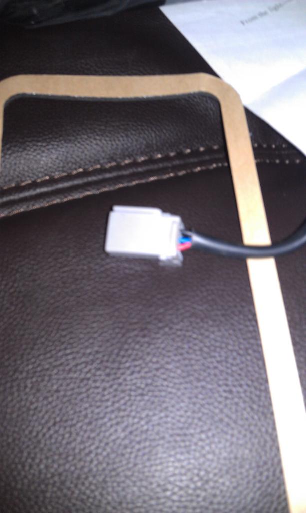

I just got my tail lights and third brake light in...the tail lights hook up easily, but not sure how the third brake light hooks up...it looks like I will need to hard wire. I have an 04 F150 FX4...here is the picture of the connection:
Sorry the pictures aren't very good.

I'm not sure, but that kind of looks like the connector underneath the headliner. I would just hardwire it.

That is what I plan on doing, however how would I go about doing that, as there are three different leads going to each bulb on the stock light, while there is only one lead that powers everything on this aftermarket light. The main lead on the stock light only has two wires, while this aftermarket one as you can see in the picture has 3 (blue, red, and black I believe)...so what would I hook into?

Does it have cargo lamps? I believe one is cargo hot, brake hot, and dual function ground.

Yes LED Cargo Lamps, apparently the one connection you see in the picture powers the brake LED and the two cargo lamps...but I dunno if I am supposed to tap into just one of the original cargo lamps and then the main brake light or what...

My recon light had the same plug the lights are on a separate harness that is secured under the headliner. you un plug the stock light harness and the new 3rd brake light plugs directly into that

Here's a pic of the stock connector.....
As stated before.....this connection is in the back of the cab above the headliner.....

You are correct I hooked it up it was under the headliner as you stated. got everything hooked up. I will post some photos of my new truck all done tomorrow in the 04-08 section if anyone cares to see how it turned out.

Take out the oem 3rd brake light. Follow the wire harness under the roof, it's back there.
