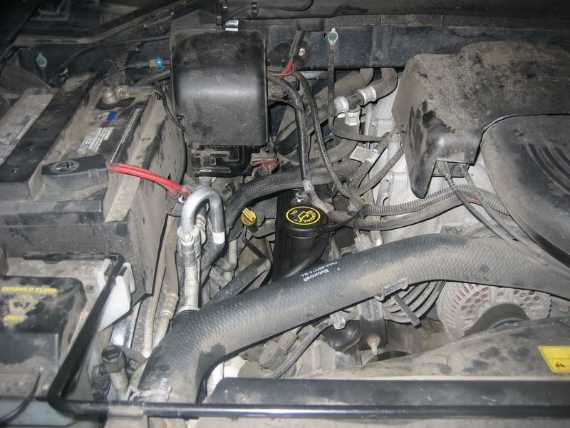

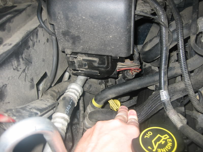

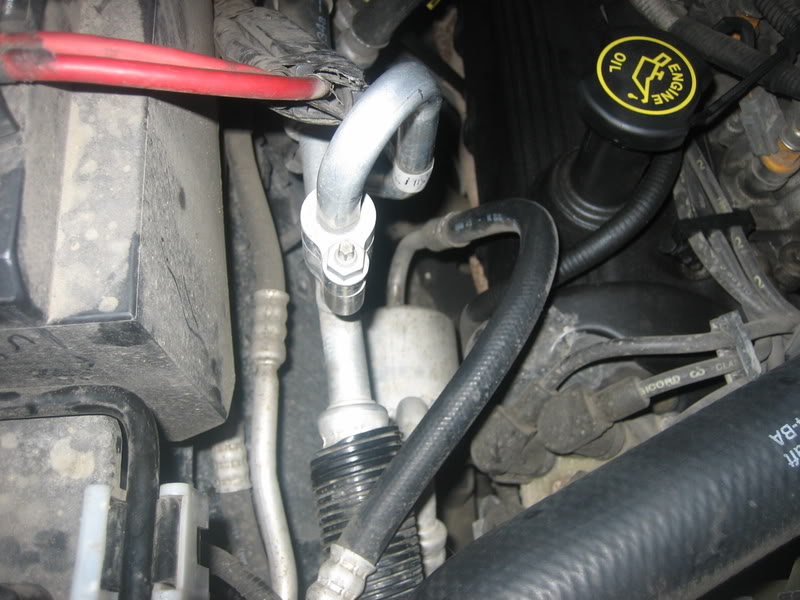

The AC does not get any better whether I am on the highway or idling and both max and AC are not cold. The compressor cycles fine I guess. I put the gage on the low pressure side. It was at 45 psi, then the compressor cuts on a reduces the low side pressure to 25 psi (this was with max AC full blast) the compressor is turning.
There is a big canister by the firewall with the low pressure fitting. Is that the evaporator, condenser, or accumulator? There is also a smaller canister by the oil fill.
One note is that of course pep boys didn't find any leaks so I was thinking maybe a clogged orifice tube? Also I dont think its a stuck blend door since I can turn the temperature **** and it changes the temp.

How to I locate the heater line to block it? Do you see it in my previous pictures?

The heater hose comes off the motor correct? Does it then go directly into the firewall?
If the low side hose is getting cold and sweaty at the compressor and the high side hose is warm to hot then the charge is in the ballpark. Maybe not perfect and certainly should be checked and charged to specs but it should at least get colder than 93*. My money is on the blend door thing.
The heater hoses will probably be close to where the a/c lines go through the firewall.
