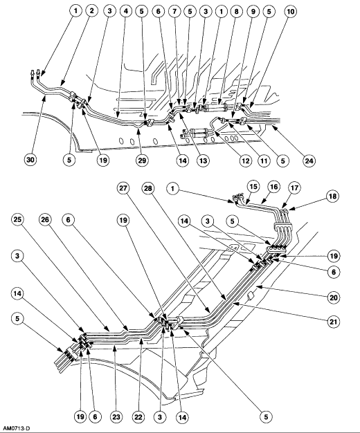

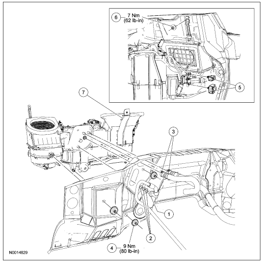

Kinda dissapointed in the schematic on Alldata.
Which one is the heater hose that I need to clamp?

The auxiliary lines are two-piece tubes that are secured to the underbody of the vehicle. New auxiliary line kits are only available with multiple-piece lines for ease of installation.

You may need to view a few more diagrams to get the right one. Another good technique is to view a diagram and then locate the parts on the car itself. Below are the ALLDATA diagrams for my F-150 that show where the hoses protrude through the firewall. See if you can find something simliar for your vehicle.
