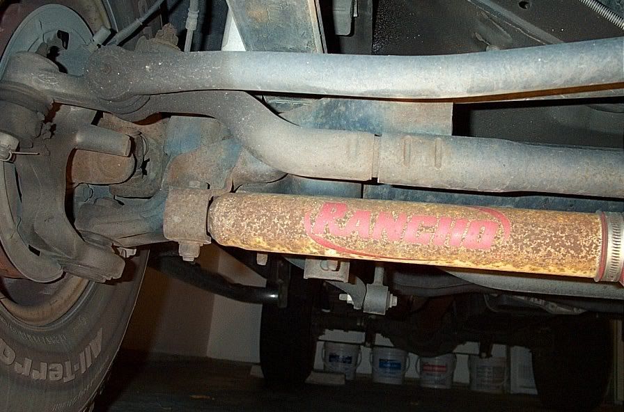

Was just wondering what the bracket looks like. I have a F350 2003 and i can't seem to find the bracket on the steering linkage.
Could you buy chance take a picture of your steering stabilizer to see your install?

Old Nov 7, 2006 | 08:49 PM
phildacf150's Avatar
Joined: May 2001
Posts: 157
From: Wentzville, MO
Yes Sir, an oldie but a goody, Here's your pics...
The first pic shows the factory bracket that sits below the axle.
The second pic shows the bracket that comes with the stablizer.
http://i84.photobucket.com/albums/k2...c/P1001237.jpg
http://i84.photobucket.com/albums/k2...c/P1001236.jpg
Respect your elders JK enjoy, don't mind the rust.
