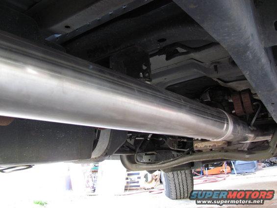

Goodbye DPF. 100 dollar pipe or a full exhaust and a tuner....you will be happy you did. and your truck will love you.
Or i can sell you my full stock exhaust and you can put a 30k mile dpf on it instead.
