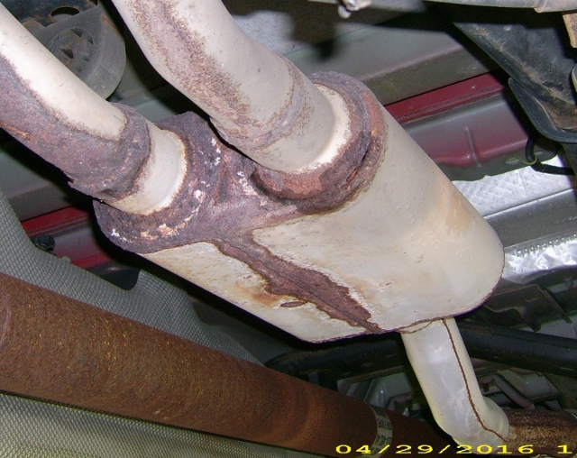

Well, recently I was under the truck looking as I heard a PFT_PFT_PFT noise. Found a hole in the rusty now FM at a seam, I knew it was a matter of time.
I posted about it:

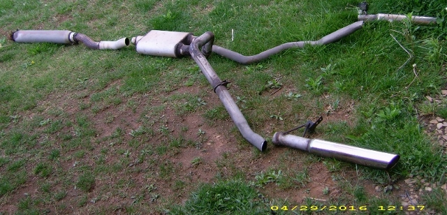

On swap day, once I had it cut apart and looking at it laying on the ground, I thought "what a mess" ..... could not believe this mess was under my truck the last 6 years!

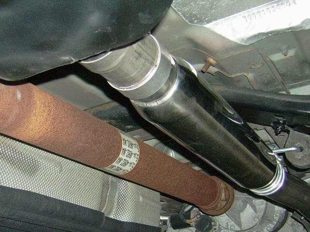

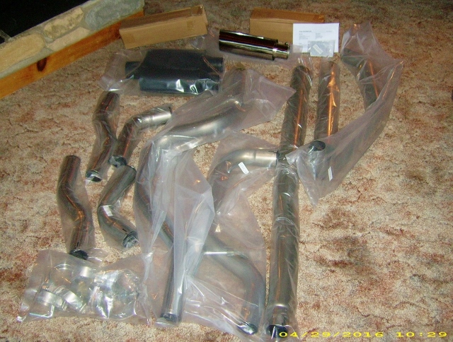

Everything arrived in one big box, the muffler is similar to what was on the truck but it's a couple inches shorter and when weighed, it's maybe a pound heavier. We are talking near 9 pounds each. All pipe ends and those of the muffler had plastic plugs in them and everything was bagged. Included were 6 2.5" clamps, 2 3.0" clamps, 3.0" OD head pipe swaged down to 2.5" ID at one end for mating at OEM Y pipe, a headpipe extension, a 2 part left side tail and 1 piece right side tail pipe of 2.5" OD, instructions, lifetime warranty, extra hanger for left rear.

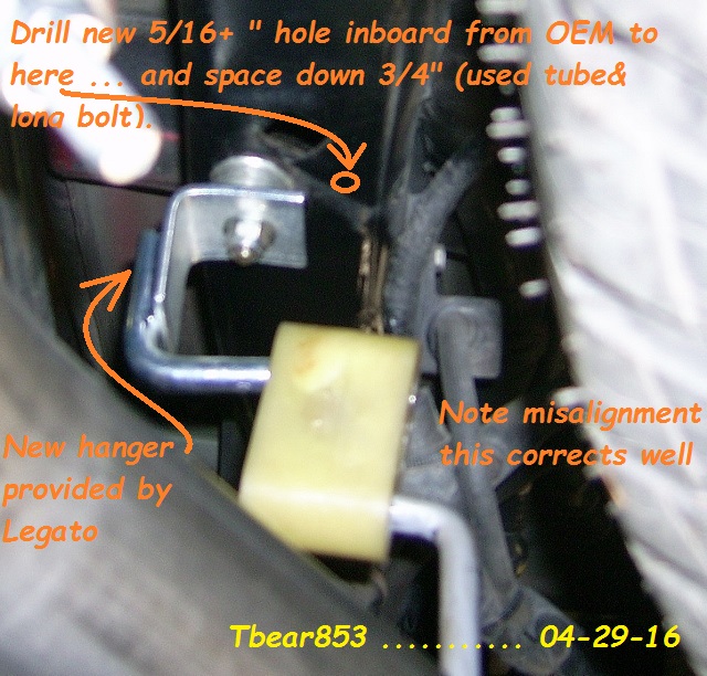

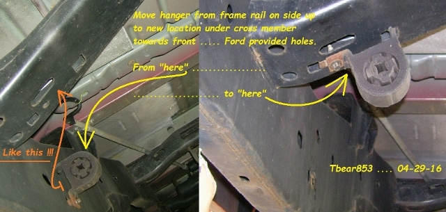

Once I had the old system off the truck, instructions said to move one factory hanger. When whomever did the old system they used their own hangers ..... but thankfully they left the OEM ones in place.

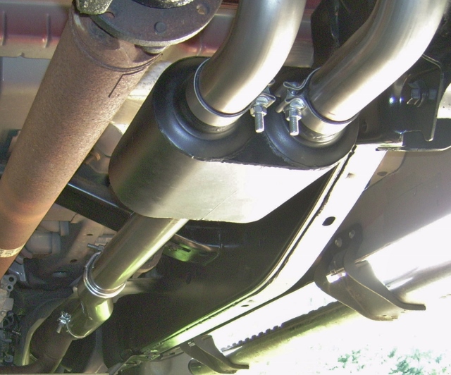

New muffler from rear looking inwards:

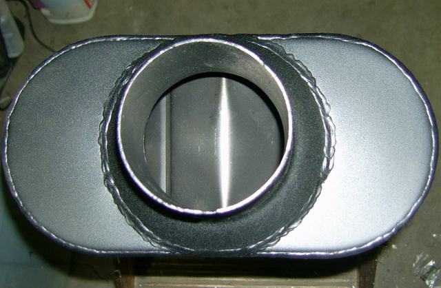

New muffler looking in "inlet":

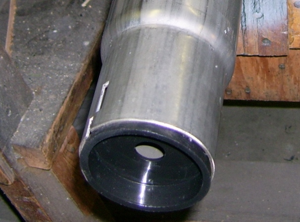

As I installed parts and worked on alignments, I found it a great tool to take a sharpie and mark the ends of each pipe where it goes into another or the muffler about 3" or 4" from end so that you can tell how far you have it inserted into the other without pulling it back out. A little thinner or 2plus2 will wipe it off.

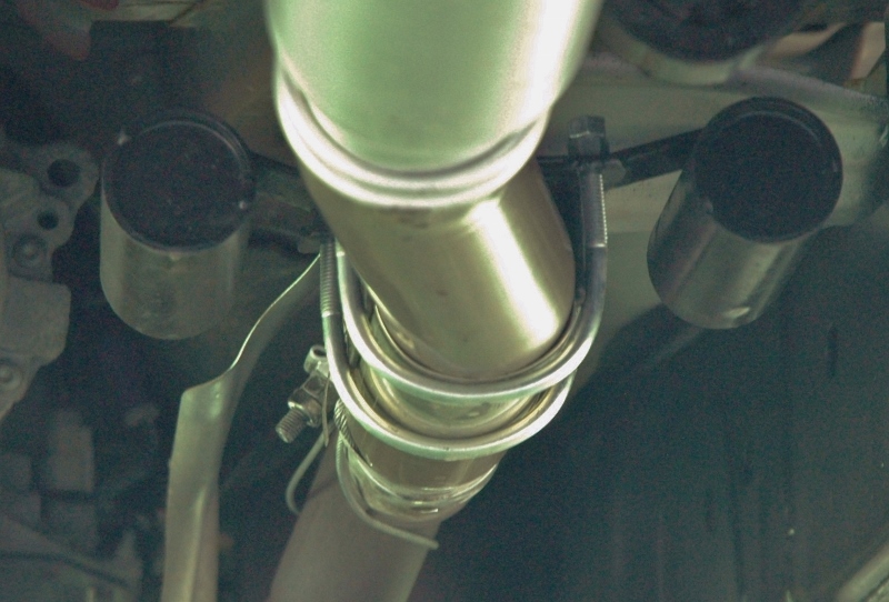

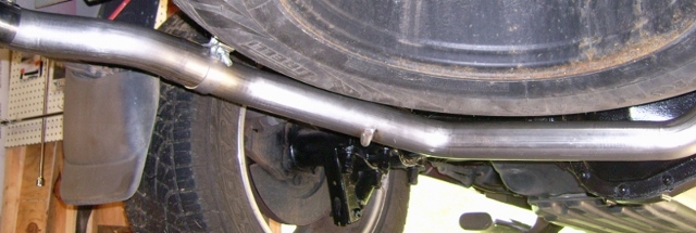

You can see the left rear pipe is routed over the axle alongside the right rear pipe and then turns in it's second part to go around the spare. There is room to get the rear axle cover off by taking it to the right if need arrises ... or one can loosen a couple clamps and move the pipe. It does not hang down below the spare much as it seams from this angle.

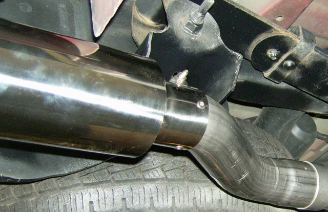

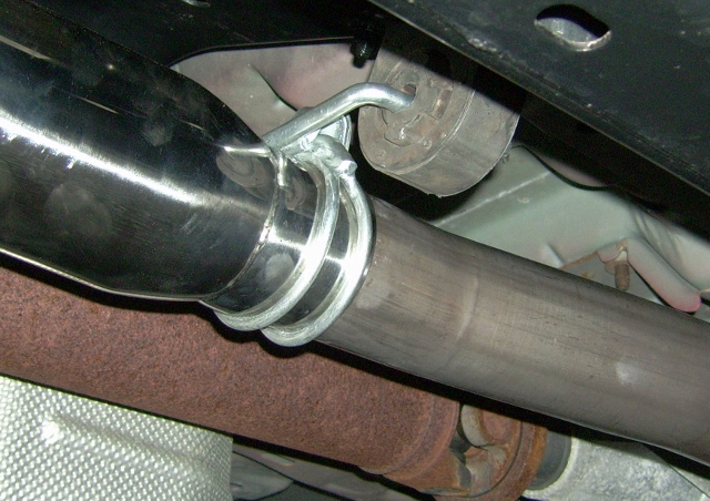

I did find that the below modification to instructions provided helped line up my tips better and get's that isolator all the way on both stubs.

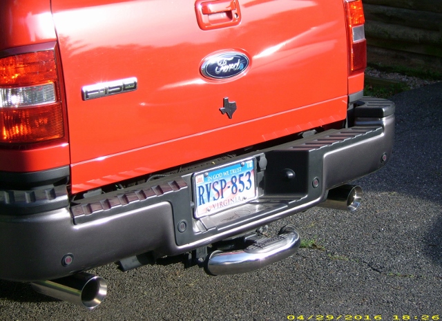

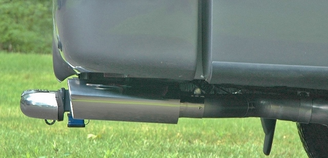

When I went to put the included 4" OD polished stainless steel tips on (double walled, about 3" ID except at rear where they clamp on to the 2.5" OD pipes) .... after choosing the straight back look (they also include turn out pieces so tips can be aimed out to side if you like .... but I used the end s to do a gentle "S" to aim the tips rearwards .... as you can see in picture) ..... I thought about the very small bolts used to tighten them up. They do the job .... but instructions mention a spot weld to prevent unintended loss. I don't weld stainless ..... but I have a air operated pop riveter and 3/16" stainless steel pop rivets. They can be removed easy enough but they will prevent loss.
Pardon the hand / palm / smudges .... the tips really have a nice finish.

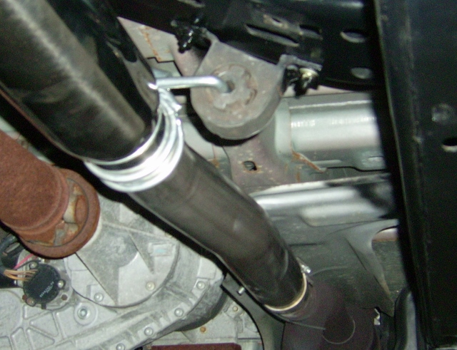

I played a lot with the head pipe in front of the muffler. I did not need to cut it or add the extension provided for different wheel base trucks .... but I wasn't sure about that "dog leg". It is a full 3" OD whole length except very end where it clamps to OEM "Y".
Over a period of some time, trying it out with muffler and tail pipes for affect on the truck, watching those "Sharpie" marks, I finally settled on that dog leg angled to about 10:00 o'clock from front when you look towards the front of the truck. I even used a angle grinder and cut a gentle notch on my final position that engages the little lock tab on the factory Y pipe outlet to index it so it would stay put as I wrestled with muffler and tail pipes without final tightening of clamps.

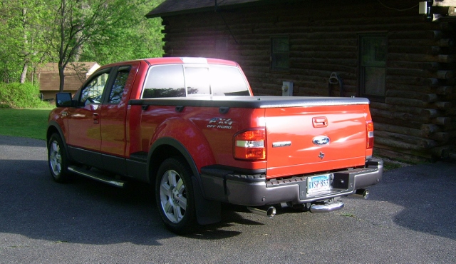

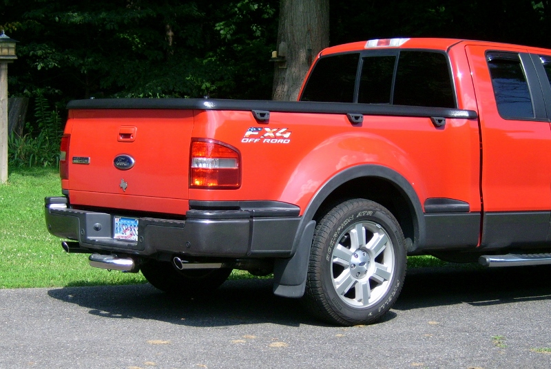

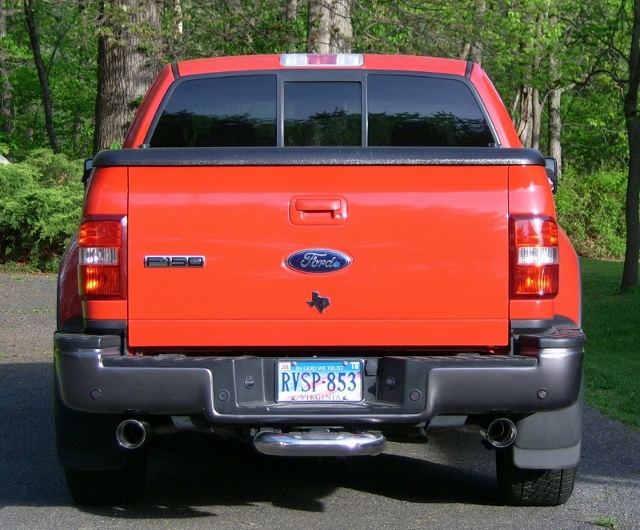

I am getting to be more "at ease" with the larger tips. I was not sure if I would like the larger OD, it seems to change the looks from the rear.
"Do these tips make my tail look too little?" .... LOL
(And I did move the left side tip / end a good 3/4" over towards center after we got home last night ....
.... but you can see it's a hair off here in this "before supper" pic.)
Anyway .... must be OK ..... last night up near W-boro on a gentle upgrade from a stop light I noticed a new Dodge PU hanging back at the rear in the lane beside me .... and after we topped over the crest, after maybe 1/4 mile total .... he eased on past me and flashed me a big thumbs up? I don't know if it was the truck, the tips, or the sound he liked???

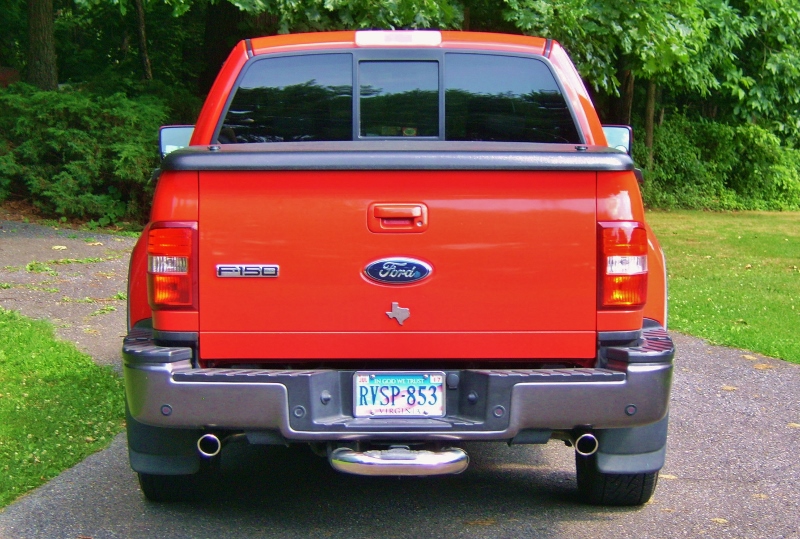

Couple of minor tweaks to tend to .... and the tips are growing on me.
I'm very pleased.

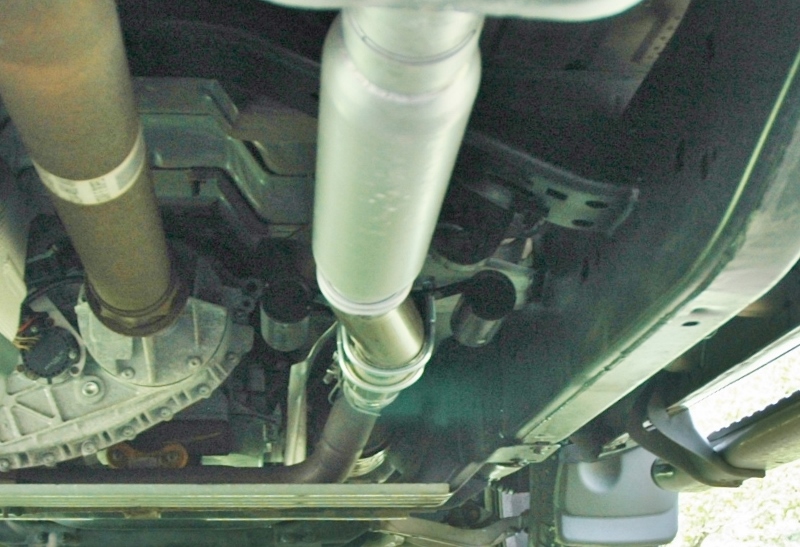

So I decided yesterday to add a Dynomax 25" long 3" ID glasspack ahead of the muffler like I did with the old system (it used a 2.5" front pipe where this one is 3" OD) .... and after pricing out the # 24242 "Red" Cherrybomb and the same muffler in stainless steel # 24241 at work today, figuring in my employee discount .... I went with the 24241 which will keep my whole system SS. All added up, the system as installed and the additional stainless steel glasspack which will mellow it out ...... I'll still be under $500 total for total SS system..
New additional glasspack is 25" overall, I removed a single section 20.5" long after cutting a 6.5" off the rear to use between the mufflers. I did use a cut-off disc in my angle grinder, makes fast work cutting stainless. Smoothed the edges, put back together using the extra band clamp supplied with a extension from Legato, and at front of glasspack I used the wire clamp with hanger hook on it ....
I did move my OEM hanger block to forward edge of that crossmember after straightening the one leg, drilling a hole in the tab and drilling two 5/16" holes in crossmember. A little paint as assembling should prevent rusting. Assembled using my marks and found that my tips were still within 1/16" of being in the same location side to side and out the back. Did not have to adjust much using my marks.

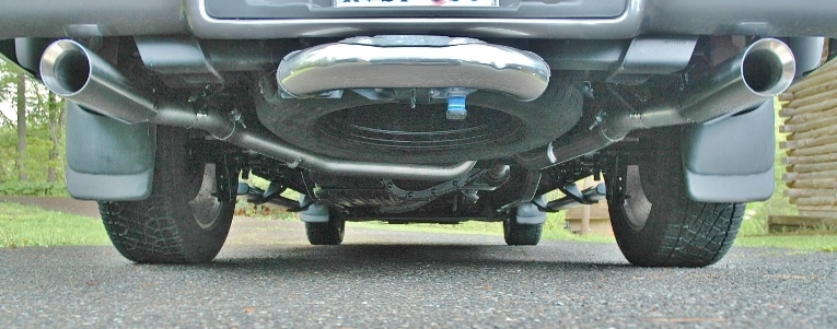

And lastly ..... a view showing pipes how they run over axle, etc .... in case someone else is "looking" ....
