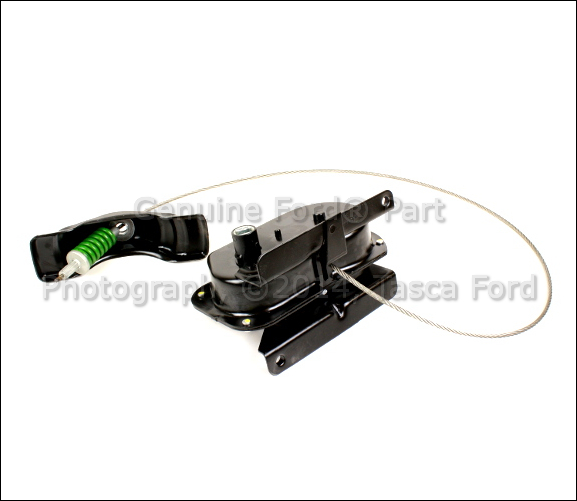

On a side note...the spring thats attached to my spare tire cable rusted off. It fell apart in my hands. I priced out a new spare tire carrier and its $230.00!!! All I need is the new bottom half the holds the tire in place.
Any thoughts on this?

As for a spare tire set, maybe find a salvage truck unit and fit that in.

About the tire carrier, a salvage yard would be fine normally. But being in MA, you may have a hard time finding one that's worth paying money for.
You could go to a hardware store and get a spring that will fit along with a cable tie. Then it's just a matter of cutting the OE cable tie off the end of the cable and putting the new spring on.
If you want to go new, I've ordered several things from Tasca before and they've been great. They're a Ford dealer based in Rhode Island.
http://www.tascaparts.com/oe-ford/2l...tr=2L3Z1A131AA

Yep, got one just like that about 6 months ago...even has the green spring lol.
Works great and it's fast.

I tried to micky mouse it but I don't feel safe with the way I have it. I trailer a boat and I'd hate to have the tire fall off and crash into my boat, never mind another car.
How do I remove that black long tube thats connected to the carrier? I'm going to remove it and purchase one on e-bay.
