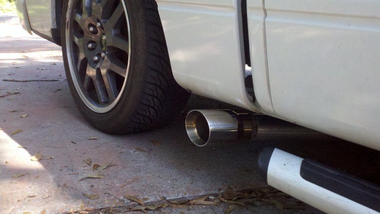

Question SIDE EXIT exhaust tip! (ANGLE)
I ordered a 3" flowmaster super 10 for my 2000 5.4L f150(of coarse). And also got a 5" outlet gibson metal militia tip. It will come out before the rear passenger side tire! I was wondering:
1.) will this have drone? (3" pipe single exit)
2.) ** how should I angle the tip?
*****should it be coming strait out?
*****or should it be angled facing back a little bit?
It will be coming in 5 days so please post your thoughts!
ANY COMMENTS ARE APPRICIATED!

Angled and it is highly likely that it will drone.

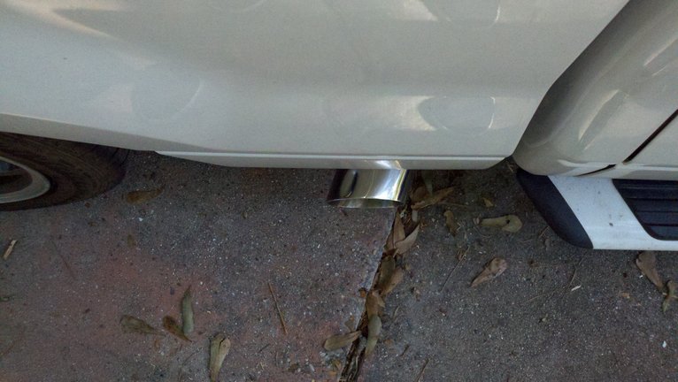

angled IMO, heres mine...
