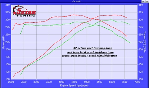

Got a link to that dyno test? Here's a much more recent dyno sheet that tells quite a different story than the one you spun.
2011 F150 5.0.
As you can see, the only difference in the two runs is ARH long tube headers versus stock manifold. Additionally, I've yet to see a dyno sheet where the gains after switching from the OEM manifolds to shorties is anywhere near the 30 hp/tq range.
Blue, get what suites your needs. If you're good with shorties (which will help more with sound than seat-of-your-britches performance), go fer it!

Originally Posted by beechkid
Unless it is for racing purposes, in all reality, there are little differences in overall performance between shorties (Tri-Y), mid-length & long tube headers.....shorties actually perform excellent up to about 5500 rpm and then will have a slight drop until 6k rpm when it begins to really decline.....more than enough for street use and much better than oem manifolds.....it was/has been an issue of contention for decades, but about 10 years ago a dyno test was run with both a street & race version of the same engine.....
apples to oranges, the proof is on here not only the fivestartuning threads, but also built54 did the conmparrison and you're so full of crap it's not even funny
