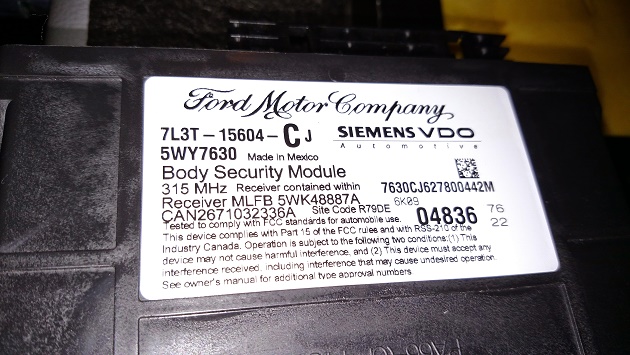

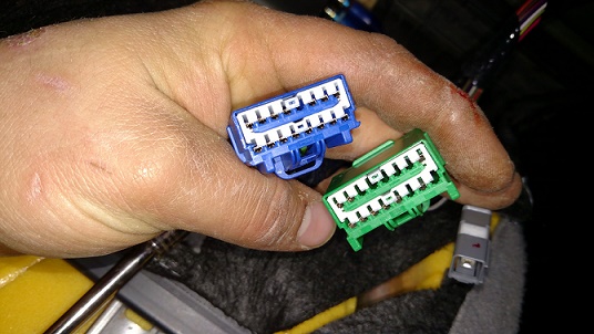

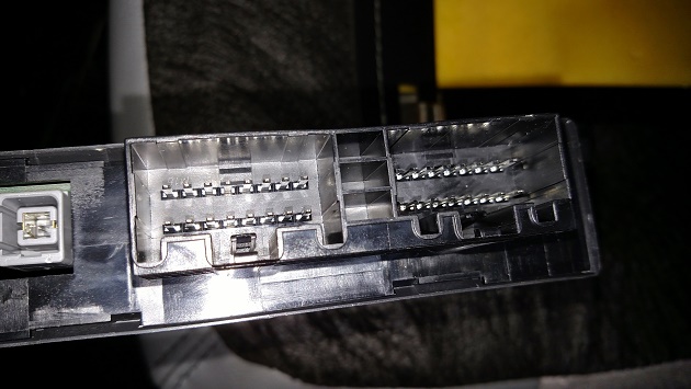

What modifications are on the truck.
- All, not just what you think might be associated with the symptoms.
Have you checked the VSM for damaged / "burnt" pins ?

Pulled the back seat and checked the BDM. all plugs looks fine and ground is good.
