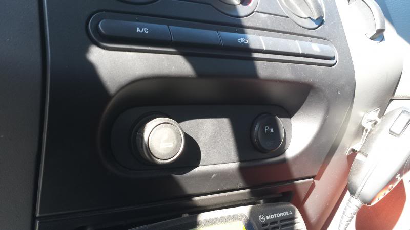

My whole panel looks different than yours ... its like recessed
07 XLT ... wouldn't call it loaded

Flow through / floor shifter vs std column shift ?

On my 2006 Lariat the one on the far right is the shut of for my parking sensors. The one on the far left is my Cig Lighter. The middle is blank. If i'm not mistaken the other option is for Traction Control.
I've never seen a model with all three used at the same time!
Cheers
Nem
