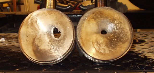

Old Mar 16, 2011 | 10:13 AM
Originally Posted by ranger332
I am going to get a Gryphon with custom tunes.. was just wondering what damage may have already been done running the CAI and possibly too lean for the past 40,000 miles.
To name a few components that can be damaged from a LEAN condition....
Valves
Valve seats
Piston tops
Spark plugs
Exhaust manifolds
Exhaust manifold gaskets
O2 sensors
More.....
It all depends.....
