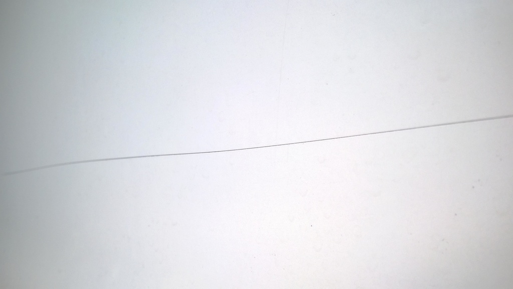

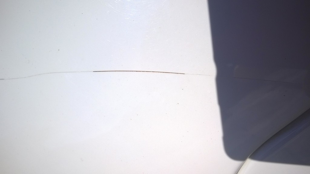

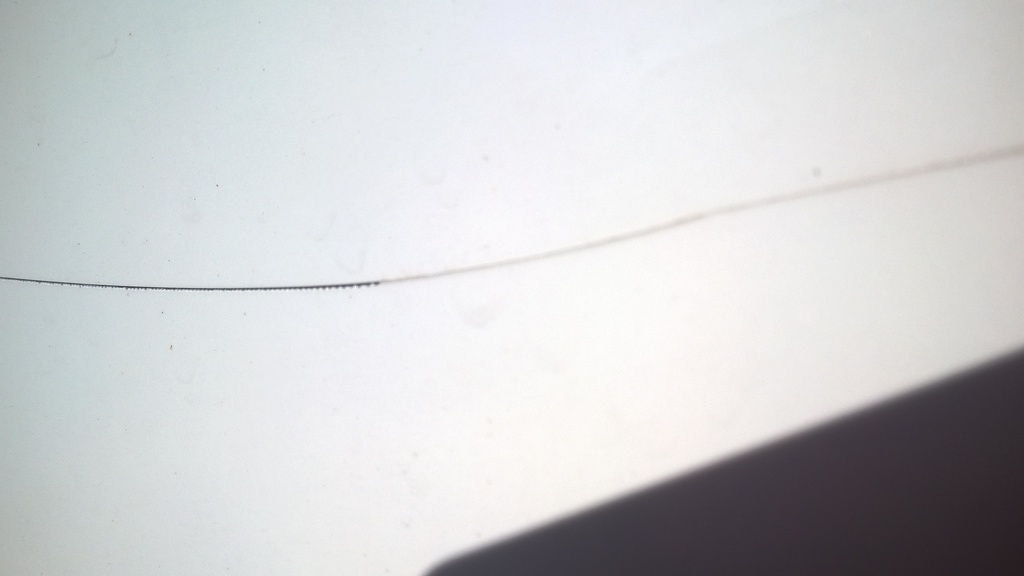

You don't say how deep the key scratch is. You MAY be able to minimize it with a product like "Scratch Out". Otherwise, you can fill it with a matching touchup paint if you work carefully with a very fine brush or paint dauber.

The scratch that was created in my paint is deep, it is through the paint and into the primer, but not to metal. I realize this might be beyond anything that I can fix. The person who created the scratch started at the passenger headlight and continued across the front fender, both doors, bedside, and across the tailgate. I tried to get some pics to show it.

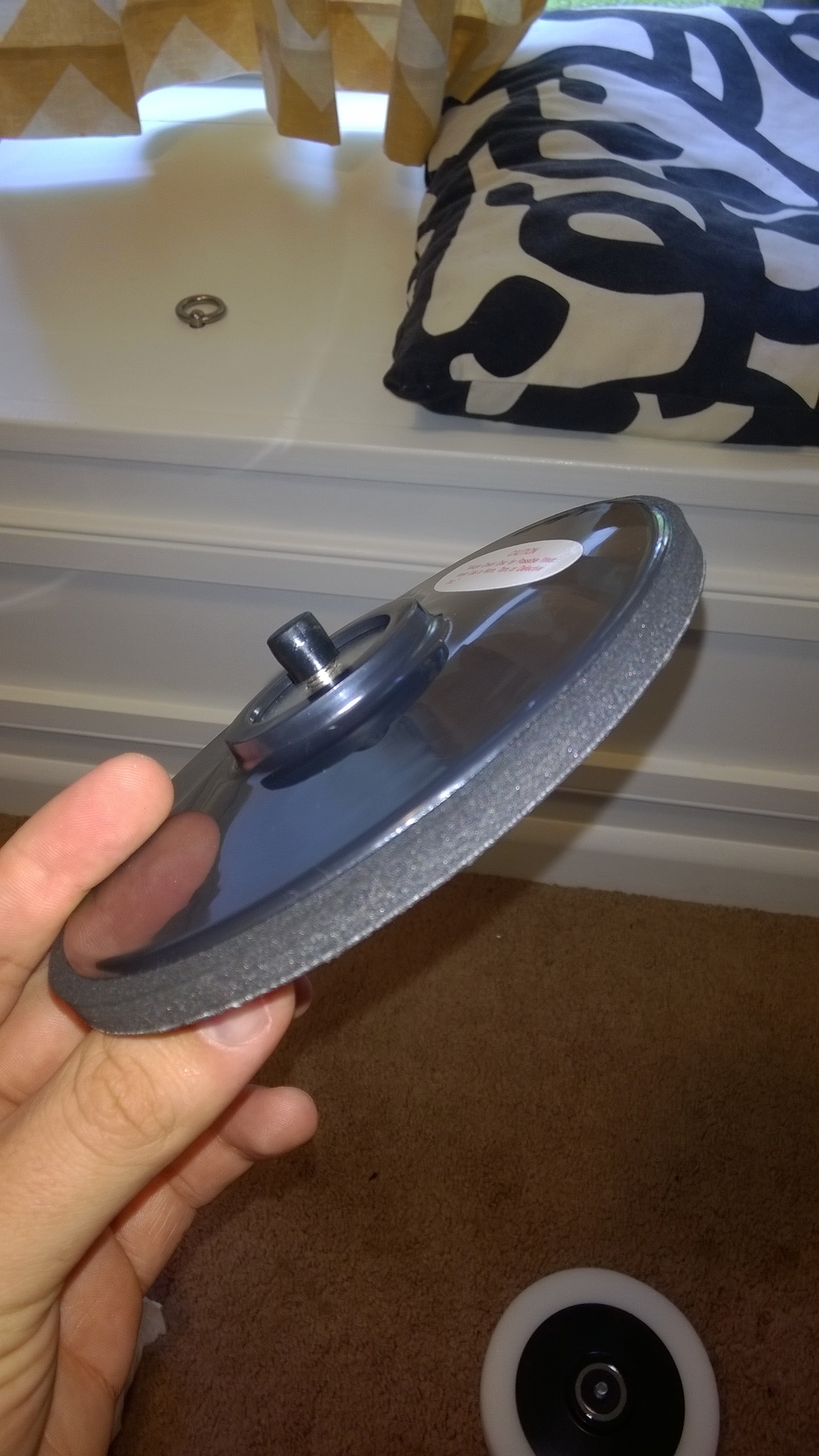

I picked up a plate also at Harbor Freight, it is not hook and loop but meant for adhesive sanding discs and is very rigid. I had planned on attaching some hook side velcro to the plate to allow me to use the hook and loop pads.
Do you want any flex or give in the plate when you are polishing? If so I can use the foam sanding plate that came with the PC, it has a little "give" in the edges and I could also attach some velcro to it.

Lets talk about my polisher for a minute. Yes my polisher is only a random orbital not a dual action and I understand the difference. I got the Porter Cable simply because I had a Lowes gift card to use. It's what I've got and I'm going to try to make this work. I can't seem to find any extra pads for it.
I read somewhere that Harbor Freight had pads so I went and checked them out. I found three different types of hook and loop pads:
