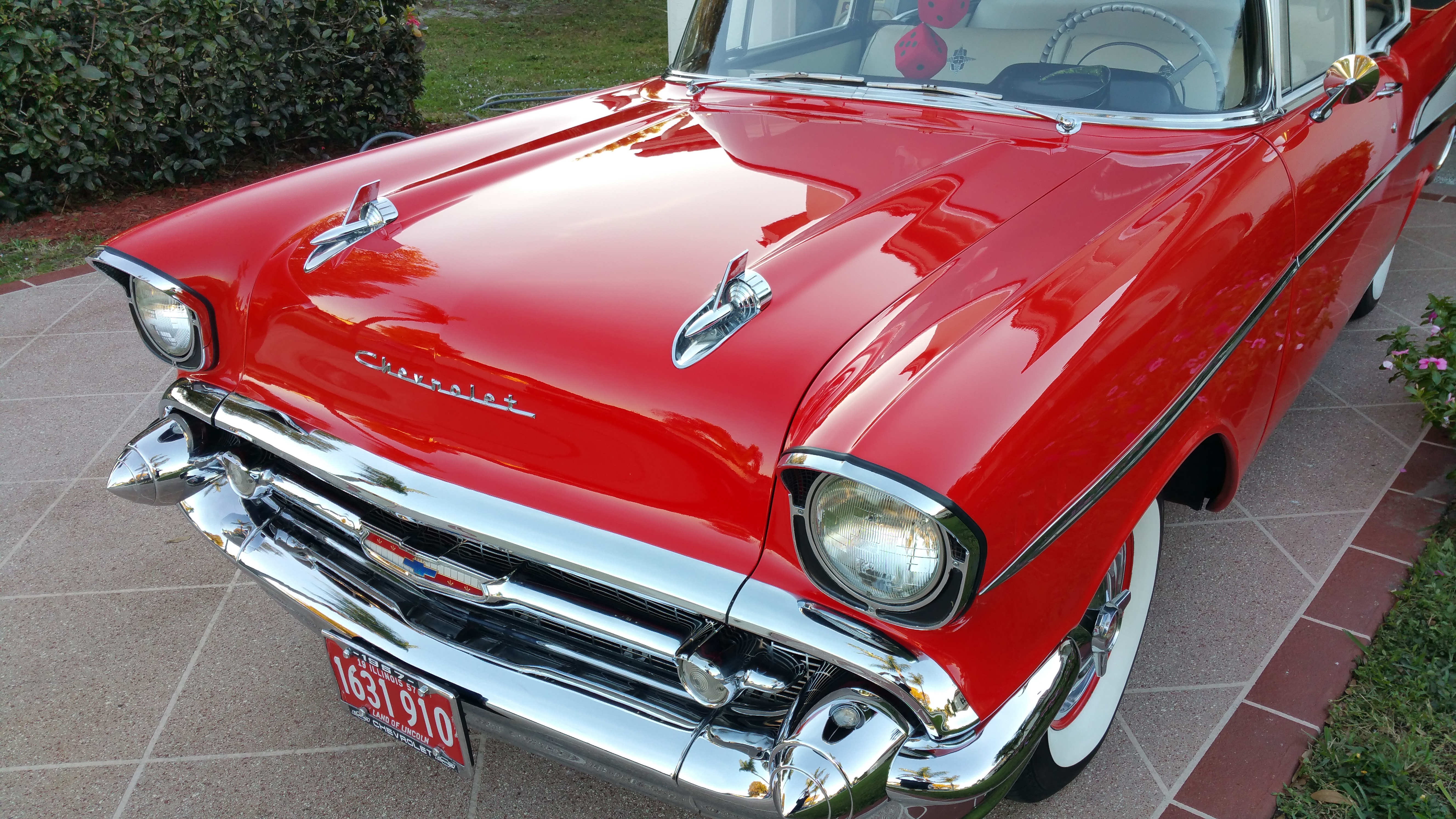

It has been quite a while since I have used Meguiars M105. I find it finicky, messy and it dusts heavily.
Megs M101 is my new gold standard for cutting (leveling paint). It is expensive but it leaves a nice finish.
If you are just starting out and you have a Dual Action polisher I would suggest Megs Ultimate to learn with.
Meguiars Ultimate Compound is based on the M105 S.M.A.T technology but it is much friendlier to work with.
Meguiars Ultimate Polish is based on M205 technology and Megs Ultimate Polish creates a very nice glossy finish.
Both of these consumer products are inexpensive and are available at Walmart or your local auto-parts store.
These are both nice user-friendly products to learn "How to use a DA". They are clean and are a pleasure to use.
OP - Are you using a Dual Action (DA) polisher for paint correction and gloss enhancement?
My favorite finishing polish is Carpro's Reflect. This is a Diminishing Abrasive Technology (D.A.T.) rather than S.M.A.T.
Using Reflect and a fine soft foam finishing pad creates a finish that is "show quality" with a sharpness, gloss and shine.
Here is a 57' Chevy 210 I recently did with Meguiars M101 (compound) and Carpro's Reflect (finishing polish).

Yea, I know...it's not a Ford.
