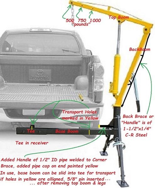

Update 11/09/20:
I've added some hand holds for the main upright in the form of a back brace kind of like the one on top boom, except it ties into the thick steel base at the bottom. Used 1-1/2" x 1/4" cold rolled steel. I also added a carry handle for the lower black boom that attaches to the tee coming out of the receiver, welded to the corner brace after slotting the 1/2" ID black iron pipe. Added some tape. I know, some will say "ruined the warranty", maybe so, but sure will aid handling. I did not support this handle at both ends, it's pipe, it's stout enough, and it clears the hitch "Tee" adapter when pushed all the way in to it to insert the pin in the transport holes. The boom or top arm is marked for 500, 750, or 1,000 pounds. It does NOT use a interior sliding beam like most shop cranes, it is set up so you pull a bolt and move the chain & hook itself.
Truth be known, I likely will not need more than 500 pounds capacity.

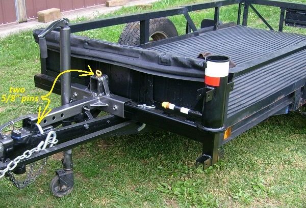

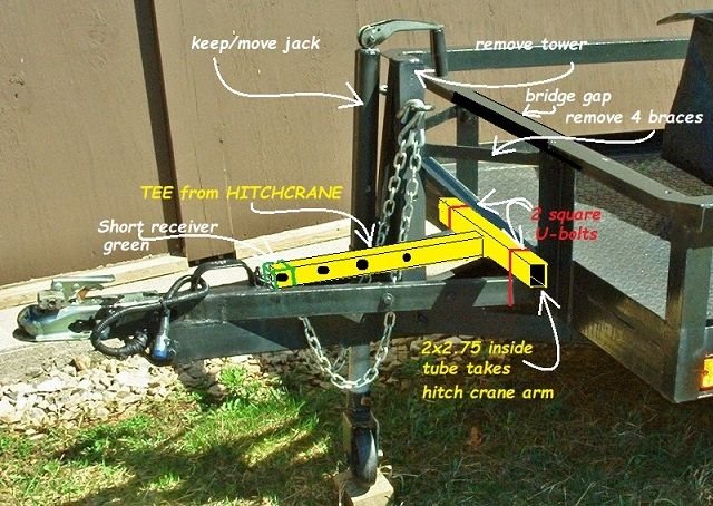

I've built a adapter cradle to fit my utility trailer at the front, it'll take the long arm of the hitch crane which is a near 4 foot long 2" x 2.75" x 3/16+ wall tube, I wouldn't use the Tee shaped hitch adaption that comes with it there, but might still put 2 x 2 receivers near the back doubling as fender holders for the rear of the fenders that I still need to mount. Getting back into my welding, I do enjoy a pretty bead.

This is a picture of my trailer, it's heavier than it looks. It has 2,500 pound each leaf springs, a 3,500 pound axle with a 4" drop built in, and the main frame is of 1.5" deep x3" tall x1/4" wall C-channel, then a near 1/8" thick steel diamond plate floor, and on top of that is a 2 x 2 x 1/8" channel perimeter and railings. It has 6 crossmembers under the floor. In the picture it has 14" wheels & 235/60-14 tires, I have some 15" alloys with 235/70-15 LT tires on them in the shed. The plywood was some left over stuff I ripped and zip tied in place to haul mulch one time, it was heaped up higher. The tongue is longer now, at near 54" ... but I'm going to put back like it was as in this picture about 32" long. The bard is 49" wide x 96" long, the rear is removable to accept wider loads ... like a trike. The shortening and removal of the tower and braces will make a lighter tongue lift. There is a "tower" which also serves as a holder for the tongue jack, but I'm going to remove the tower and 4 braces and remount the jack as removable or to swing up. Below is a picture with a drawn in "TEE" (in yellow) as used with the HITCHCRANE I'll weld a short receiver on the tongue, and use two square type U-bolts at the cross piece which accepts the 2 x 2.75" hitch crane's main arm. I'll use a standard 5/8" hitch pin at the front. This will allow me to pick up loads and swing into the bed with ease. I will also bridge the opening in the rail intended for the trike's front tire.
This is as the tongue was originally, I added 22" years ago, but it made the tongue heavier too. Going back as doing so lightens hitch lift and will let the crane put loads on my '77's tailgate ... or into the trailer.. Gonna put them new fenders on after I put the taller 15s on.

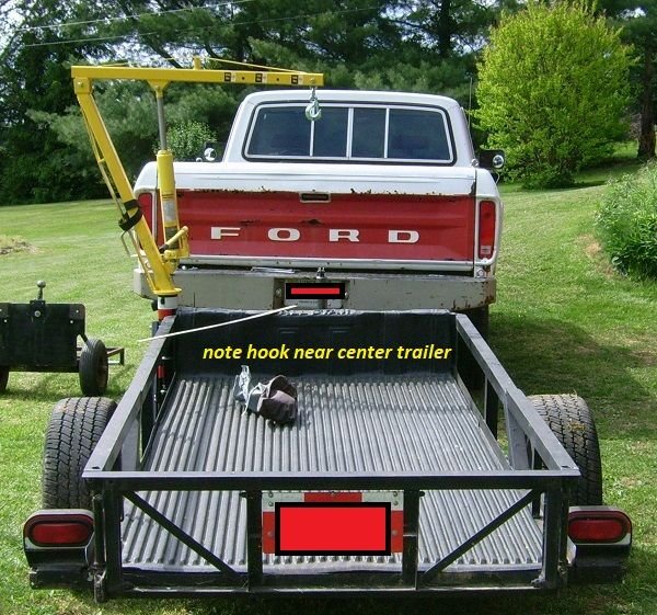

So yesterday I did some playing with my hitch crane, it's adjustable, I also tried my adjustable leg struts, they work well. I have a couple little items to tend to, need to modify a piece on the Tee to make for easier insertion of the base's arm, but generally pleased. I can use it on either side of truck or trailer, and can move it further out if needed. I also found my drop hitch works very well but no pics of it dropped, it really is to stay hooked to truck and trailer but allow tilting. For a latch, just use the fixed hitch. I added a square u-bolt over the fixed hitch to lock it in place.
I know from this that I can use the set up with either the '77 or the '07.
When I finish the last mod (today's plan), I'll also be able to insert the base arm straight in from the rear all the way, easily, and that would place the crane dead center, like if needing to skid a log. As it is, it'll almost work but the paint is too thick on the base so it "sticks". It will work on the '07 too except on it the spare is in the way, so likely I'll only do that if using the '77.
The adjustable struts will allow a wider leg spread for lower set ups. They adjust 6" from 15 to 21" center to center by just screwing one end out or in. The screw adjustable struts will let me adjust the legs precisely in cases of trailer or ground un-even-ess. . In the picture on the truck, the Tee is all the way into a very heavy duty 2x2 receiver I made in the '80s, the boom pivot about 1/2 way of the tailgate down, the hook will climb to 48" above the bed. If I move the TEE out 6" (2" steps via 4 sets holes) gets the pivot close to tailgate top edge when down.

I had the '07 out back 05-18-21 , I did set part of the crane in place to ascertain it'll work on it too, it does. But that truck sits lower and with bed cover, likely I'd use the '77 for any serious lifts. But with my longer leg struts that will allow the legs to be used at lower heights, it'll work. I reworked the TEE adapter so now the arm of the crane's base adapter will slide in and out to be secured by long pin. In use, the crane could be transported either cross ways or length wise. On the '07 the arm passes a inch or so below the spare tire, but on the '77 it sits just below the long receiver bar of my DIY hitch built many years ago. That "arm" is very nearly 3.5 feet long, well short of hitting important things like axles.. I also added some tape just because I had plenty.
The crane takes weight by it's legs, the vehicle just adds mass and a third leg to stabilize it. I can see where a jack would be of help if one picked up a heavy enough item to compress springs as there could be binding in the joints. Placing just a bottle jack under the hitch would prevent the vehicle springs compressing with a load until the user was ready to remove the crane, then he can let the jack down.
