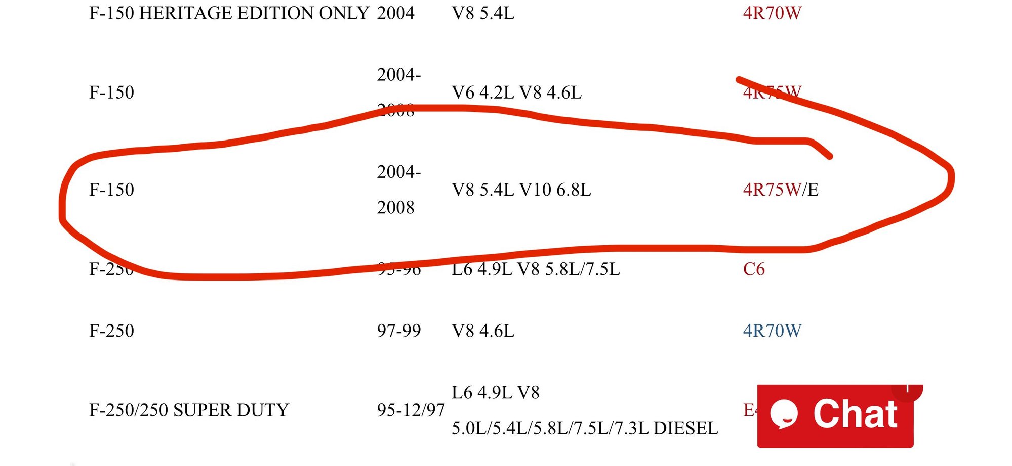

Your 04 has a 4R75W, not 4R75E, essentially the same. I think the 2013 trans can be made to work as long as the transmissions are the same length, but it's not a direct interchange. There may be some electronic differences.

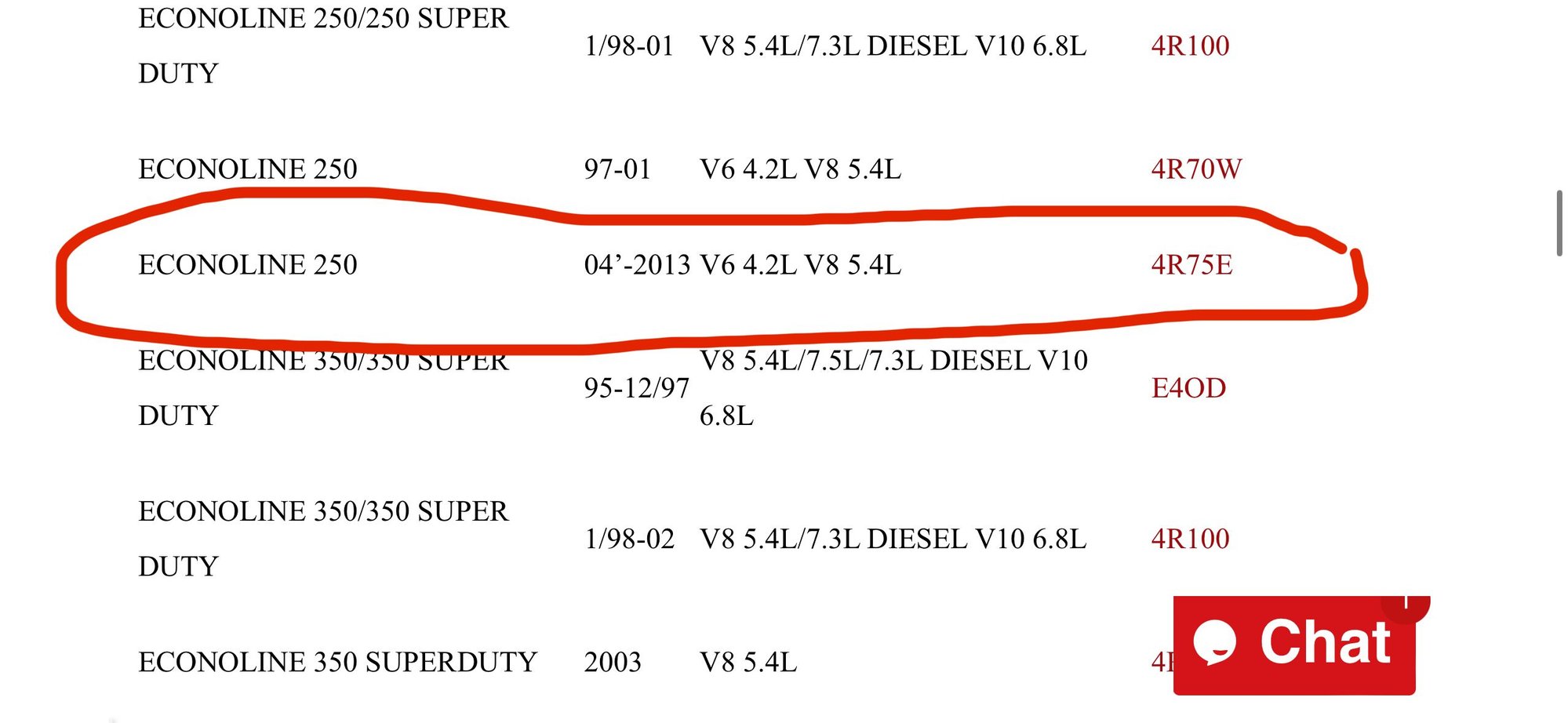

The 04 was made with both the 4R75W and the 4R75E according to the Ford website and the transmission identifier tool.

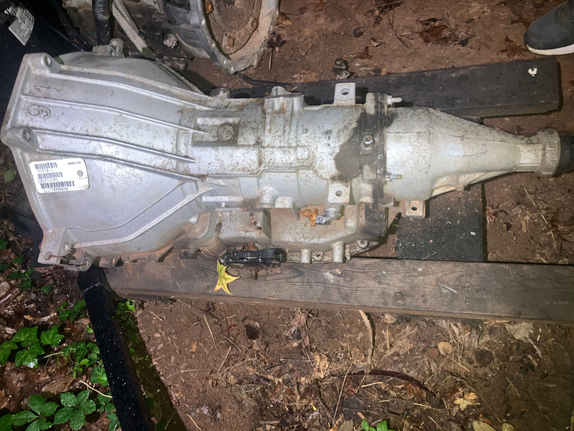

My transmission has two sensors on it so it must be the 4R75E.
this is the transmission pulled out of my 04 F150 5.4 v8 2wd
