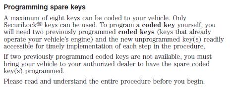

3. Programming a PATS Key
There are 2 ways to program a PATS key.
3a) You have 2 PATS keys that already are programmed = FREEBIE!
3b) You only have 1 PATS key programmed = Costly
Unfortunately, you must visit the Dealership, or a properly equipped Locksmith. They will have to connect a special tool to the PCM and perform the key programming for you. Roughly costs $40-50 (1/2 hour labor) for this service.
