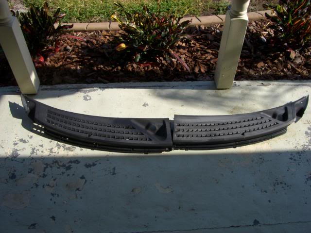

Next I cleaned everything really well. I sprayed down both pieces with Simple Green, scrubbed them, then rinsed them off and set them in the sun to dry:
After they were dry I used some rubbing alcohol to rub them down and make sure every last bit of grease/grime was off.
Then I painted them.
I used Krylon Fusion in gloss black and then some Krylon clear coat. Go very slow and do EXTREMELY thin layers at a time, wait a minute, then re-apply. Take your time. I was in a hurry and messed up a small part that I had to go back and fix.
Let it dry (only takes about 10 minutes) and then apply the clear in the same fashion.
Then let both pieces dry for about an hour so you don't screw anything up.
Then it's time to reinstall the colw, in the opposite order of the removal.

So here's the before:
And now the after:
I used a small amount of the low-shine armor-all I had left. I'm extremely pleased with the results. The total cost of the project was $7.50, and the amount of work (not including drying time) was about 1.5 hours.
It's not exactly perfect, but it is leaps and bounds above what it was, and I'm very happy with it, especially the cost.
