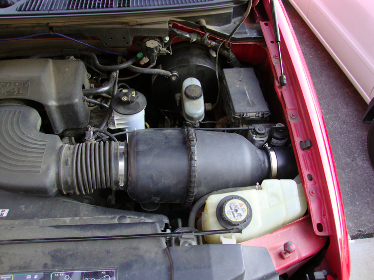

Just did mine today on my 4.6L 2000 FORD F-150.
Pretty tricky to sand the PVC pipe and get it exactly fit into the fender hole...
It went in but there was still some space around the pipe, minute spaces though.
Started the truck after reconnecting everything and it felt better.
Soon to be hitting the road and testing this mod out.
Thanks Guys!

Just finished doing it...ended up with my own version as I knew I was able to make something work with what I have. I had a chunk of 4" ss tubing so I cut the air box so the 4" fit nice and tight, cut a 6" long piece of the 4" and put it in the stock airbox about 1/16th of an inch and JB welded it in. Then I just enlarged the hole in the inner fender. Its not reversable, but it was free! If I find the JB Weld doesn't hold it I'll bring the pipe up to by buddy's shop and put a couple of bead rolls on the end where it goes into the air box.
Here's what I ended up with:
Took me a good 1hr to 1 1/2hr's to get this done, can't wait to drive my truck and see what kind of difference it made.
How did you cut the hole in the fender bigger?? That looks sick I deffinatley want to do that when it warms up outside. I bet you noticed alot of improvement aswell.
