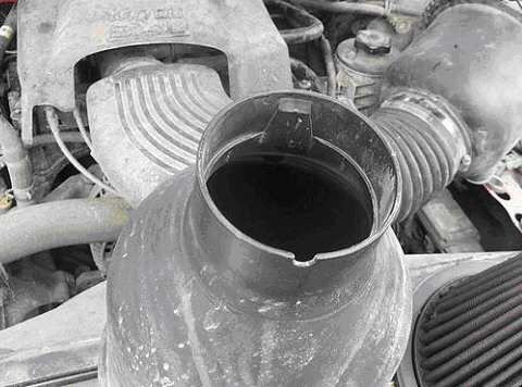

I am attempting to do this mod now finally. Truck is a 2000 F150 XLT 5.4L 4x4. I bought it used many years ago and it already had the K&N kit on it. I never liked how it sucks the heat from the engine compartment. Living in Arizona I notice a performance difference during the summer. Also I don't think it filters as good as they say, but that's another topic. Since I did not have the stock intake, I bought one off of eBay from what I thought was another 2000 F150 5.4L. What I got was the intake from a 1997. My question is does anyone happen to remember the inside diameter measurement of the filter housing after removing the snorkel? These different years appear to have different size openings.
This is what I received which looks like what I've also seen in pictures of the V6. As you can see the snorkel connects on the outside of the housing.
Based on pictures from others performing this mod, this is what I should have.
This piece snaps into the inside opening of the housing.
My concern is that the opening on the one I received which I measured to have an inside diameter of 2 5/8":
and the opening on this:
do not have the same inside diameter. If I go with the one I received I would be choking the engine. What tipped me off was when you connect the 3 inch rubber coupler to the housing and PVC pipe that goes into the fender, there is a good 1/4" to 3/8" gap all the way around to seal off on the filter side and is just way too loose in my opinion to use. The VIN number this intake came off of was on the receipt. It shows it's from a 1997 V8, 1FTEX18L3VKC57705. Maybe the difference is due to when Ford went to the PI heads? Thanks for any help you can provide.

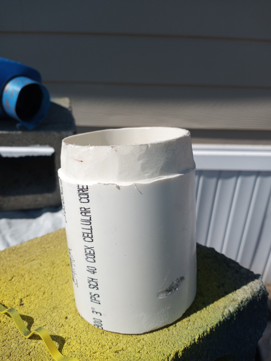

did this mod for 20$ I am currently installing it now only gona be a 10 min job.. I also pulled the silencer out in the big L piece can’t wait to put it back together and see if it did anything

Did the mod.
They maintain a list of those doing the modification.
2002 f150 4x4, 4.2l, 5 spd manual tranny
my truck came with the smaller end on the filter cone so I cut the cone further up before attaching the rubber. Still not as big as the other fitler cone type (I'll buy one later) but opened it up some. Sounds a touch better but primarily gives me better high end rev at highway speed. We'll see how it goes. lol
