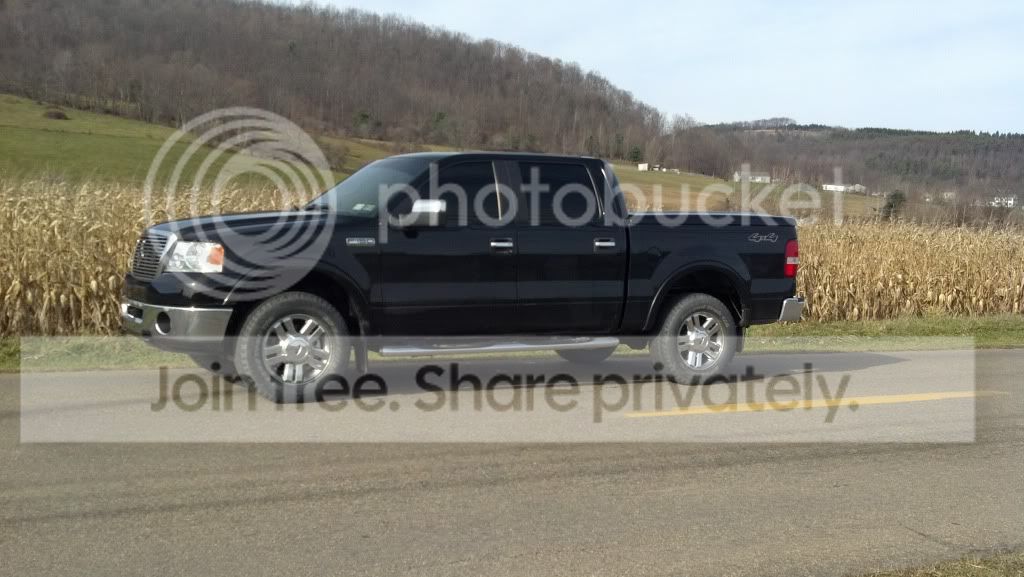

You want to do what I did to my truck pretty much, went from this,

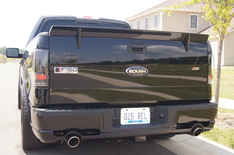

To this,
All of the plastics aside of windshield wiper cowl, and rear bumper step pad have been removed, smooth sanded and properly shop painted & cleared to match. Chrome bumpers were removed and sold off and I used non OEM primed bumper skins and had them painted in the same fashion. I intended to keep some chrome accenting, so I retained the chrome pull levers on handles, swapped to the thinner OEM step boards ( took forever to find used ), and bought hte Harley Davidson edition grill.
I wasted too much money in this truck but it looks great with a ton of mods. IF you have a couple grand, so for the paint match work if you intend to keep it for a long time. I am glad it is painted up.

Fully painted mirrors ( swapped my chrome cap covers with a friend ). Also the glossy b-pillar covers from eBay.

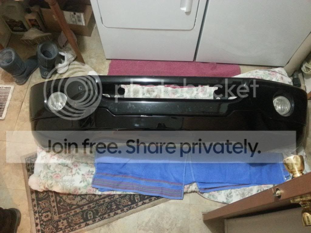

Painted front bumper with Harley Davidson valance.
