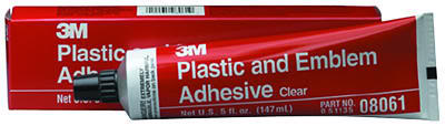

You can use the 3M double sided tape, but it's sort of thick. Instead you can use 3M Emblem Adhesive available at auto stores like Pep Boys.
Scuff the backside of the emblem with sandpaper before applying the glue for better results.

I would highly suggest not using glue...
Why?

If you look around, you should be able to find the double sided automotive tape not only in different widths, but different thicknesses.
i would highly suggest not using glue...
x2^
