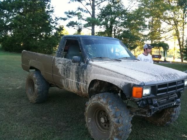

It holds up great....I've done entire trucks in it (my old toyota 4x4 and my old ranger 4x4) and took them threw the woods with great results

Here is the ole yota I did its on 36" swampers.....
