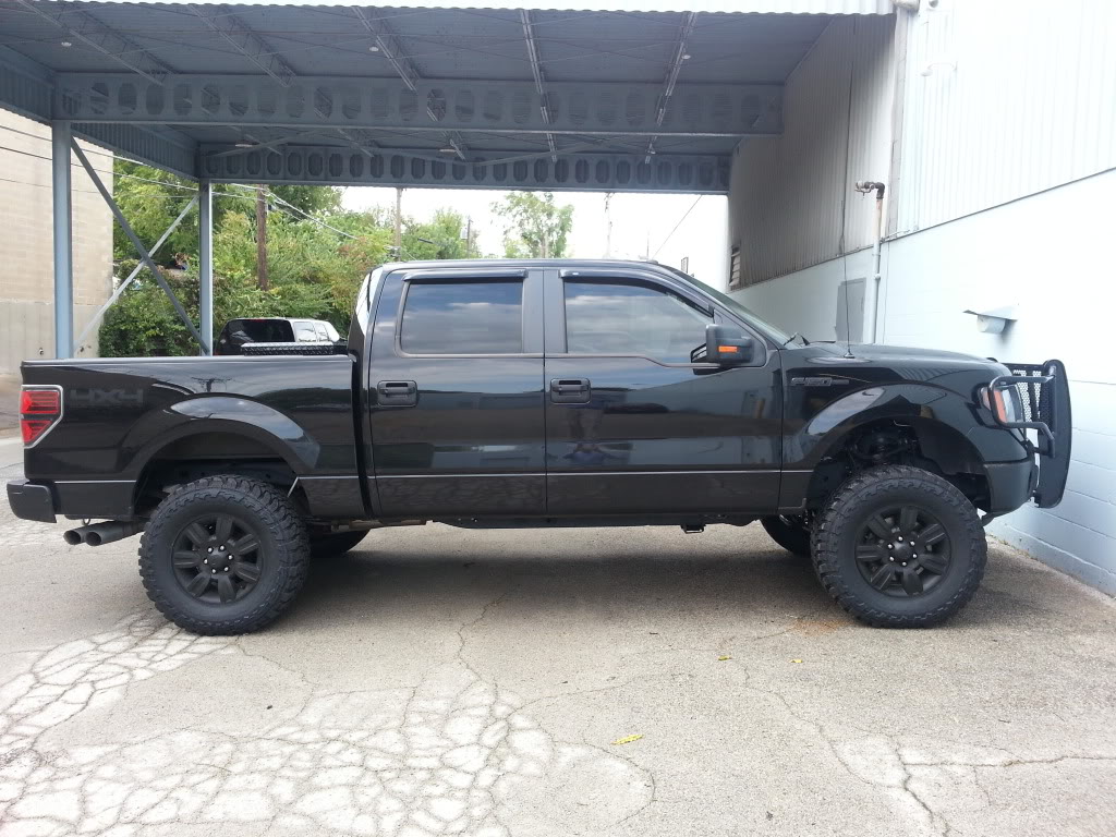

Rancho 4" Lift Installed w/ 35's
Here are some before and after the Rancho Kit.
Before: 2" leveling kit running 275/70/18's (33's) on stock wheels.
After: Rancho 4" Lift Kit w/ 9000xl shocks. Running 285/75/18 Open Country M/T's (35.1's) on stock wheels.
Plasti Dipped weverything I could find Chrome.
