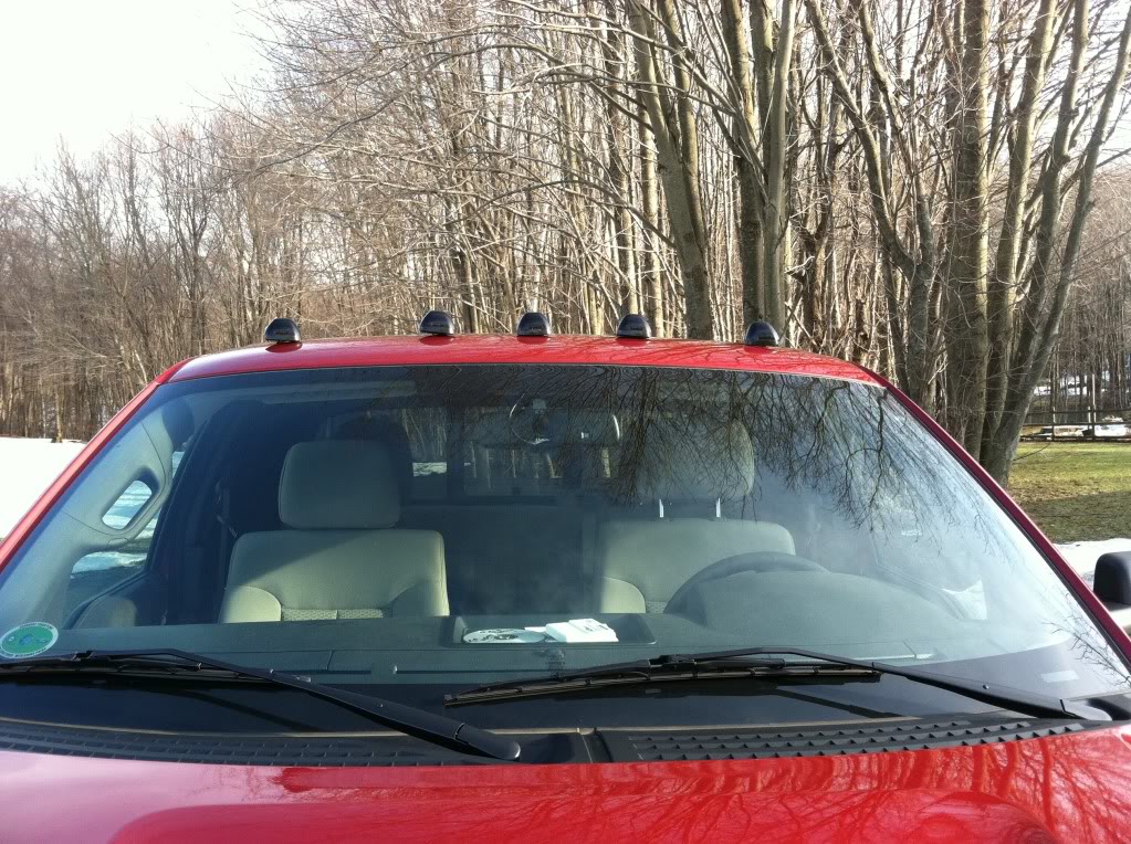

Due to my new injury (severe concussion) I won't be installing my running lights soon but was bored today, being forced to sit and do nothing. Below are pics w/lights placed on roof to get a rough idea of look.
Opinions please

Old Mar 14, 2011 | 09:54 PM
r8rone's Avatar
Posts: 98
From: El Paso, Tx
Pics didn't show up?
