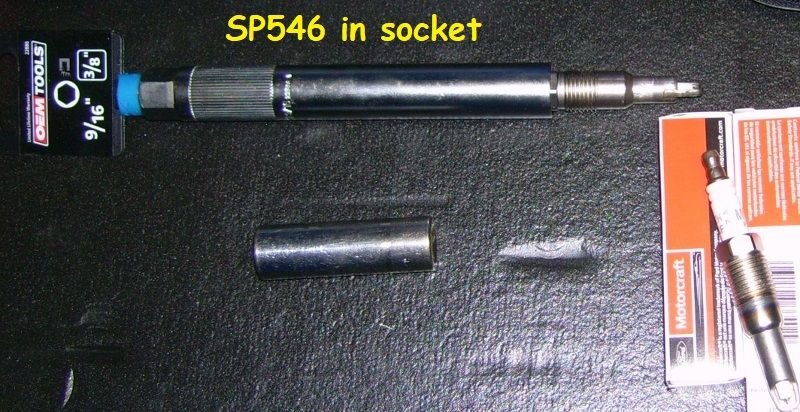

Today, I took a few pics and made notes:
The socket with magnet inside
That test fitting drew my attention to coil spring seat / top of plug when SP546 left some of 9/16" flats in view.
Look close, you can see where ground strap is attached, but measured across attachment it remains at same as OD of lower barrel.

I did not have a OEM installed SP507 to compare or measure the lower barrel, so I don't know. After I change them out, I'll try to remember to revisit this thread.
I did find a sheet of specs, http://www.fordinstallersupport.com/...logs/spark.pdf and on P-3 it states a barrel dia for these 507s (what I searched for) as 10.0 mm. which is 0.393701" which is pretty close to the 0.393 - 0.394 range I interpolated it to on the SP515 and SP546 plugs new in box. So "diameter" looks unchanged.
I did note that the sealing taper or step down on the 546 plugs is somehow "more pronounced" but not sure what it means. No bluing. I hope that it means the lower shield is better attached … or maybe one with upper plug body.
